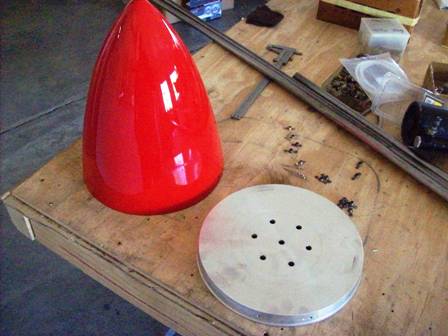

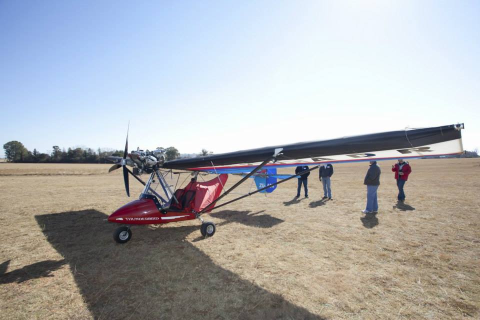

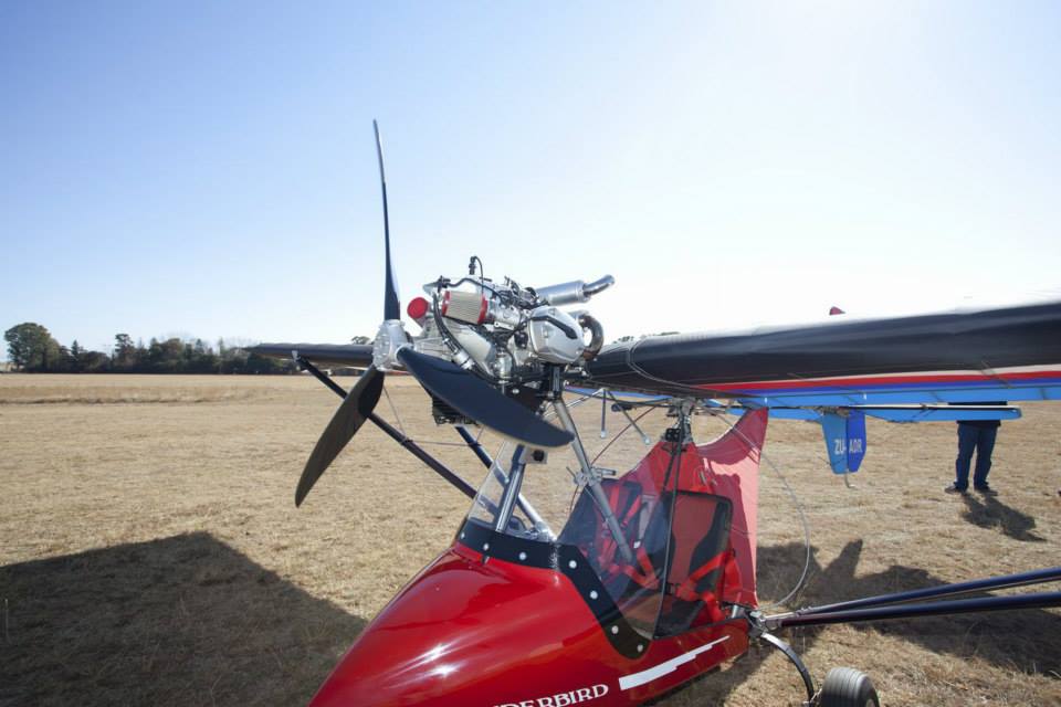

Hi AndyCap
I am busy with 2 projects at this stage and my first priority was the Skyjeep so we did not spend much time on the Tbird. The problem we had was a vibration. We had to experiment with the engine mount rubbers. This is now sorted and it is running very smooth.
Performance wise, this TBird is a monster. It climbs at well over 800 ft/min and that is in cruise climb. I am still getting used to it so am taking it easy. The amazing thing is the fuel consumption, at a cruise RPM of 5200, I am getting less than 11 l/ph. I am still calibrating the fuel flow meter but am not out much. Speed wise, did not gain much, the Tbird remains a Drag monster. At 5200 rpm is about IAS 70-72 mph BUT then at 11 l/ph. Compare to the 16-19 l/ph previously. Makes a big difference.
I am using components supplied by Takeoff UL in Germany.
Well, at last she is home at Kroon
Home at Kroon airfield
At Kroon.jpg (47.72 KiB) Viewed 11426 times

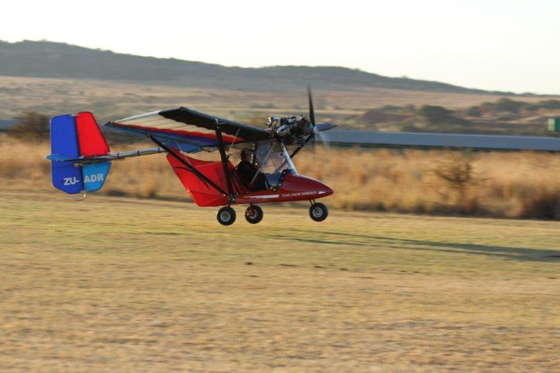

And just to show that she is actually flying....................
She also has a very distinct 'growl' that is definitely not 583 or 912.................
