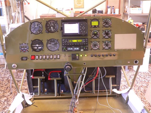

Dusty Eagle wrote:I had the panel cut at Metal Centres in Booysens.If you need a number, please pm me.
It was their first attempt without a cad drawing being prepared, but with a bit of time and fine tuning, panel # 2 came out exremely well.
The first panel was a little extravagant, in that we made it both too high and too low. The hight interefered with the windscreen and the low came a little close to the knees, workable, but I changed that as not all the space on the bottom lip is needed.
The seat and floor boards & pedals were in before the panel. The seat has 40mm sponge in and even with the new panel angled forward, I comfortably reach the Garmin 296 in its panel doc at the top.
We havent tried with seat belts yet as those supplied do not fit.
Same guys who cut the KR panel for me...

The first panel was 1.6 aircraft grade alli, but the second was 1.6 normal domestic.

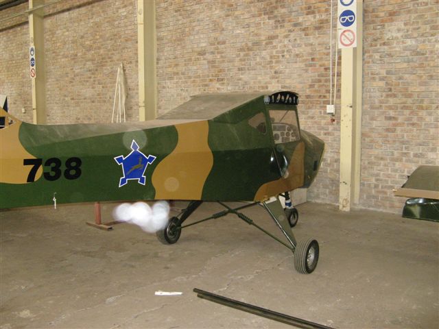

The colour scheme reminds me of another Bushbaby I saw that is Peter's own personal plane I believe. I saw it at his workshop when I went to go fetch the kit
11 - more instruments.JPG (66.82 KiB) Viewed 6204 times

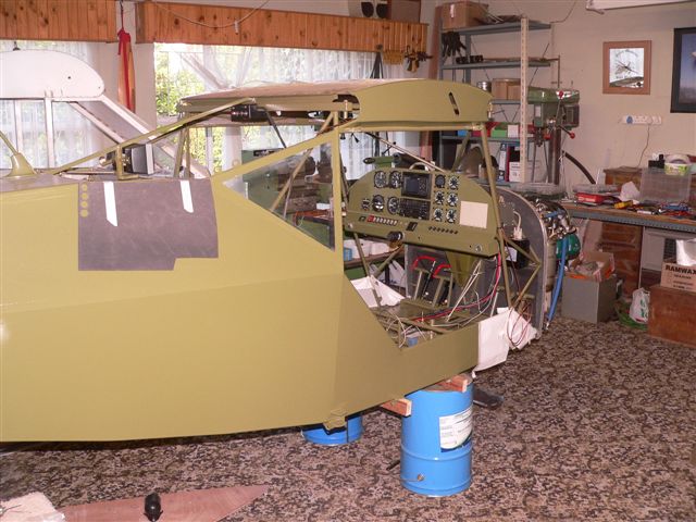

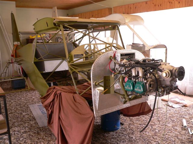

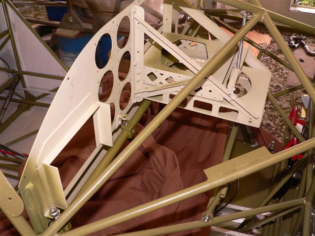

Some more pic's of the progress
bUSHBABY 073.jpg (67.29 KiB) Viewed 5947 times
bUSHBABY 049.jpg (63.68 KiB) Viewed 5938 times
bUSHBABY 051.jpg (69.77 KiB) Viewed 5950 times
KFA
Posts: 2789
Location: Now at Petit (FARA)
Re: Bushbaby Explorer # 130
Postby KFA » Sun Apr 05, 2009 6:03 pm
And more
bUSHBABY 076.jpg (66 KiB) Viewed 5935 times
bUSHBABY 081.jpg (42.93 KiB) Viewed 5949 times
bUSHBABY 082.jpg (49.89 KiB) Viewed 5932 times

PS I LOVE that SAAF scheme on the BB - really cool!! - Should be a Tailly though and needs a nice red spinner like the SAAF C185's and some of the Bosboks

The camo is nice. I have gone for a drab olive green with some matt black trim and a red spinner is on the cards and perhaps some red decals.

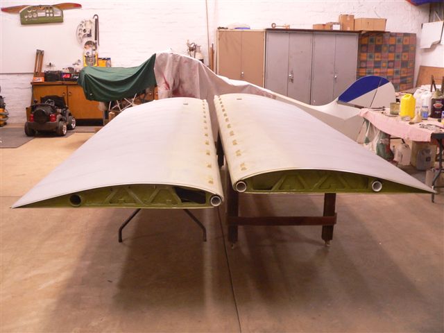

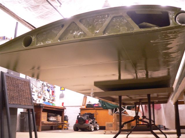

Had a major setback on Wednesday.
I finished the first tin of paint on the underside of the wings as per the photo, they came out nicely with a mid sheen
I turned the wing over and used the paint from can # 2 [ which was mixed at the same time ] and this came out a full gloss.
I also painted the tail feathers at the same time, also gloss.
I will have to have the paint rectified, sand all down and respray to match the fuselage.

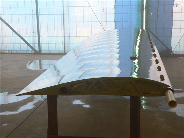

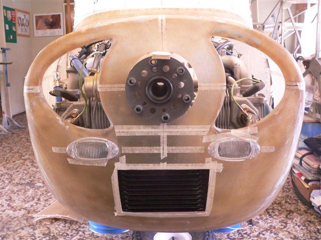

Postby Tailspin » Tue Apr 14, 2009 8:03 am
Hi Dusty
She is really looking Fantastic !!!!

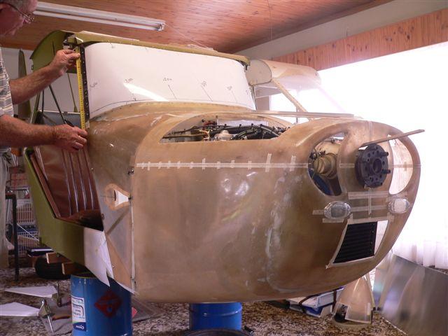

Here are the Pic's you requested !!!!
The Wing.
bUSHBABY 117 (Small).jpg (37.13 KiB) Viewed 5628 times
Side view of Nose Cowling
bUSHBABY 120 (Small).jpg (45.74 KiB) Viewed 5638 times
Front View Nose
bUSHBABY 122 (Small).jpg (55.08 KiB) Viewed 5625 times

Postby Dusty Eagle » Tue Apr 14, 2009 11:49 am
Many thanks for the pics Tailspin.
The lights will be fitted from the inside of the cowl when the cut out's are complete, the oil cooler's sides are being rounded and extended to the cooler. I can imagine that there may be too much cooling there but there will be space between the oil rediator and cowl to perhaps fit an adjustable louvre, if necessary.
The bonnet arrangement works great, lots of access for preflight and servicing.
