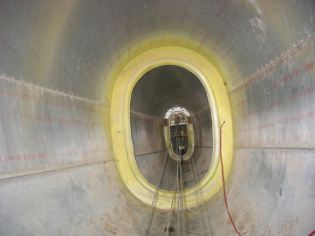

Aircraft aluminium is an alloy hence it does corrode, but they put a layer of pure aluminium "ALCLAD" 1 thousands of and inch on the surface to help it be corrosion proof. So if you scratch the surface it will start to corrode.
The reason some people only put it on the mating surfaces, is because that is where you will get relative movements and it might start to corrode there first.
Priming does add weight and more work to an airplane, but typically it will last longer and hence it will fetch a higher price on resale.
You can use corrosion prove fogging product like corrosion X or what ever to help with it, it does have some negatives, like forget about trying to paint after treating it with it, it goes everywhere, so use as last.
That all said many airplanes from the 60's still is fine without any corrosion protection.
The picture below is picture of bomber rear fuse from the 1940/50s. You can see some surface corrosion but functionally stil sound. Check the top skins vs the bottom. Bottom is mostly covered by gunk and dust.
My RV is painted with an epoxy primer on some strategic skins, like the bottom ones, my plane is going to outlast me! You can see most of the gunk goes on the bottom.

Hi Rudi,greylingr wrote:Aircraft aluminium is an alloy hence it does corrode, but they put a layer of pure aluminium "ALCLAD" 1 thousands of and inch on the surface to help it be corrosion proof. So if you scratch the surface it will start to corrode.
I stand to be corrected, but 6061T6 does NOT have an alclad layer. Not needed since it's corrosion properties are much better than 2024.
