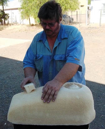

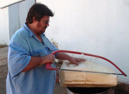

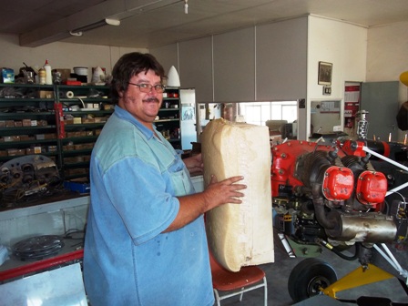

Today we started making the cowling. The nose bown first, because that is to be made from fiberglass. Started with the normal block casting. and cutting and sanding and sanding............ ## ## ##
By chila-time it was ready for the grouting compounding to start.
Start with this rough block
Cutting to shape with my "precision tool"
And some sanding. Note that an off cut block of poly u foam is used for all sanding. No sanding paper involved!

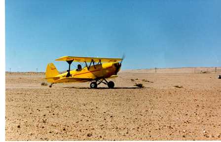

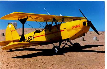

This aerie have a rather colourfull history. It flew on a veriaty of engines. Gypsey major, Continental 0300, and Lyc 0 320. And the prototype flew with a continental A65!! If it fits under the cowl, it is too small!! :roll: :roll: Here is some of the many guises she wore over the years. She was built originally during the late 60`s, and was test flown early in 1970 by one S.Levine! vhpy vhpy

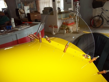

Windscreen.

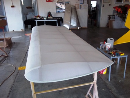

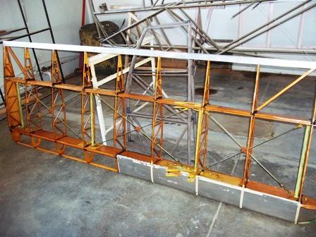

Just in case you okes thinks we are doing bugger-all around here! :roll:

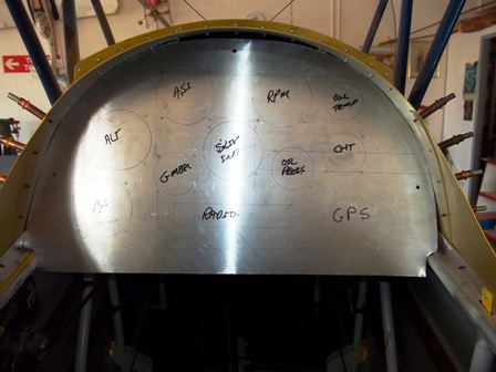

New panel
Yes, and both the top wings are covered. Now for the lekker job.... rib stitching!

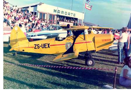

Some more pics of the biplane in days gone bye. Supplied by owner, Gino Noli, desert pilot, and book writer of note. He gave me a signed copy of his latest book, about the early Diamond digging days of Kolmanskuppe and Luderitz. Thorouly enjoyed reading the book, Gino has a knack of making history sound kind of funny. He had many adventures with this aeroplane. Write us another book about....... UEX?? (^^)
Gino and Tom Claytor, the lonely around the world pilot in his C180.
At Margate EAA many many moons ago.

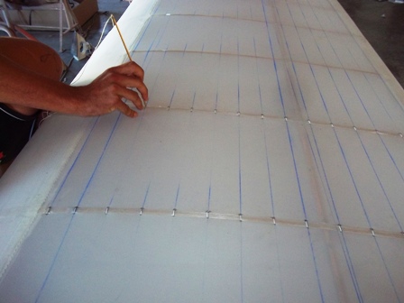

Postby Boet » Thu Feb 09, 2012 7:52 pm

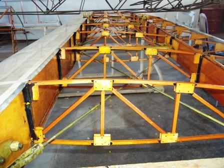

Well on our way with the rib stiching. A time consuming tedious job, but it has to be done, and done right, for this boidy is stressed for 9 positive and 6 negative! vhpy
2" rib lacing spacing. Making VERY sure.
