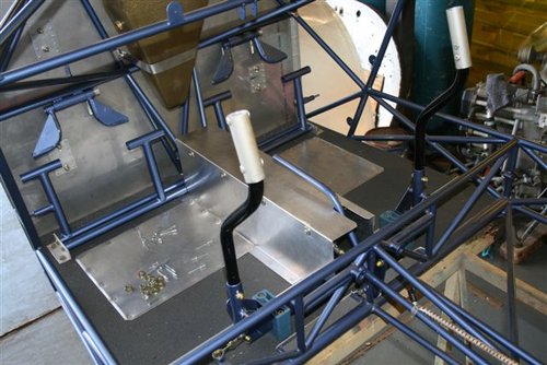

Juan,
look at installing some alli plates where your heels will press down on. It will keep the carpet cleaner also.

Will steel your Idea of the plate under your heals, will look great with the dark carpet.

On another note, we use a plastic floor carpet which is easy to keep clean. The carpet tends to hold grass and sand but looks nice.

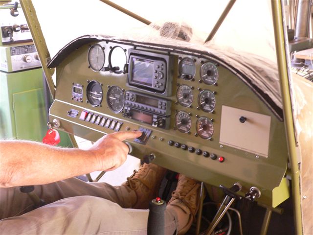

Dont know what you intend to do with your instrument panel, but I have a blank panel laser cut and unbent, the same as mine in the pic.
If you can use it, please give me a shout.
Looking good, but much work ahead.

Thanks for the panel offer, but I already got all the instruments I need and little diff than yours.

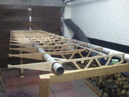

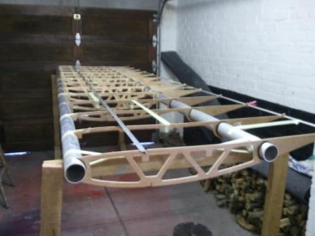

The progress on the wings

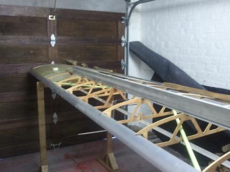

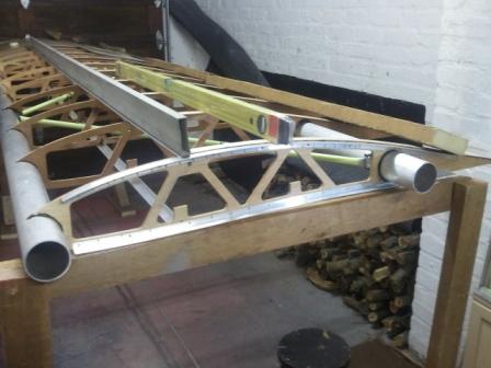

Second wing

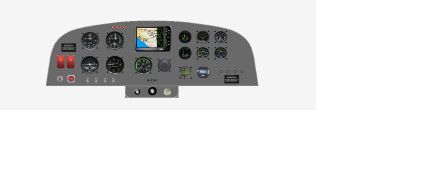

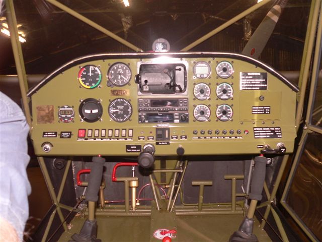

This is what I plan to do with the panel. Got almost everything, only short the GPS. Going with Airbox 7" foresight
