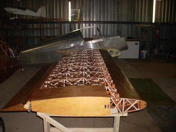

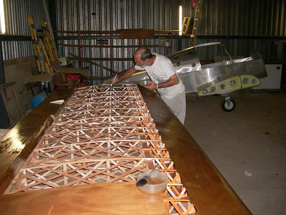

Just got back from the hangar after a decent 4 hours of graft but we ran out of varnish again and had to stop another 150ml and both wings would have been complete :twisted: :twisted:. Seems we are gathering steam now and will do another few hours tomorrow and possibly Friday aswell.

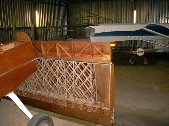

Some pics
Fuz now looking clean and glossy
The old man doin some varnishing

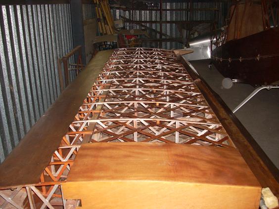

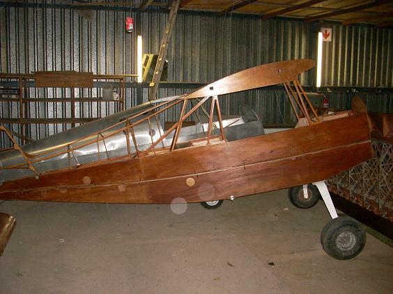

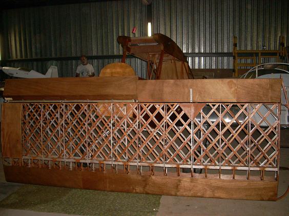

ANother lekker evenings graft complete worked from 6 - 12 pm and the entire airframe is now sanded and varnished, some other small jobs completed aswell
completed wings
completed wings

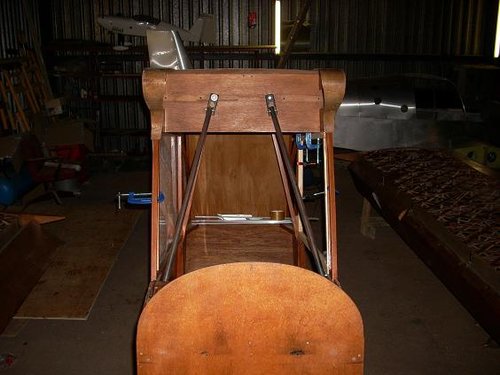

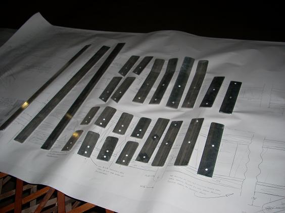

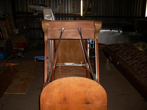

Over the weekend most of the replacement Alu parts were manufactured, wheels breaks serviced. Need to make a list of al the bolt sizes so that I can get all the correct AN bolts then we can start rigging this up again.

Few hours work done tonight and happy to say that all the Alu upgrade parts are now finished vhpy

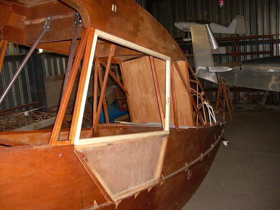

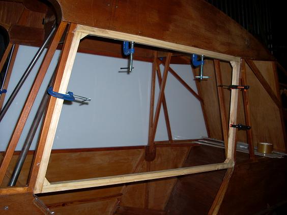

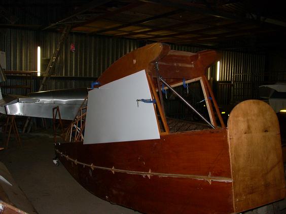

Postby Go Vert » Tue Mar 29, 2011 11:55 pm

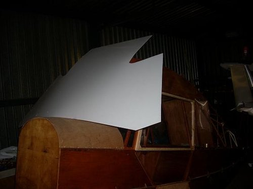

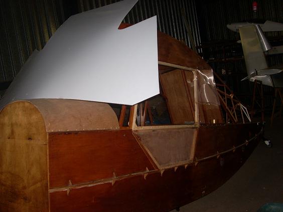

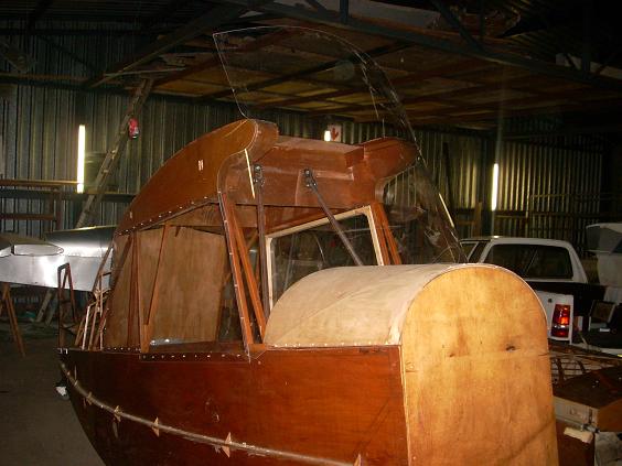

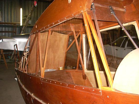

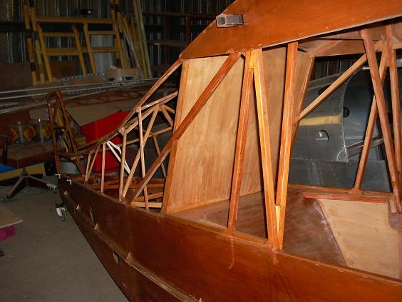

Started on the doors and windows this evening, the top door was not so lekker so I remade that quick then did the STB side window, also managed to break lots of material attempting to bend the windscreen :evil: :evil: :evil: the cabane struts are now also complete.
som pics

Trev, that new door looks awfully tight. I think it needs to have about a 2mm gap. Remember wood expands and contracts PLUS there's varnish and paint still to come :?:
Looks good so far. !!!!

Duck Rogers wrote:Trev, that new door looks awfully tight. I think it needs to have about a 2mm gap. Remember wood expands and contracts PLUS there's varnish and paint still to come :?:
Ahha you haa very good point there, I have a machine thatcan take some off will do that tonight.

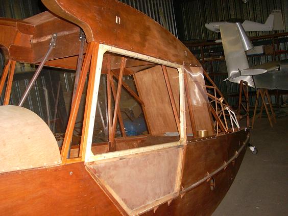

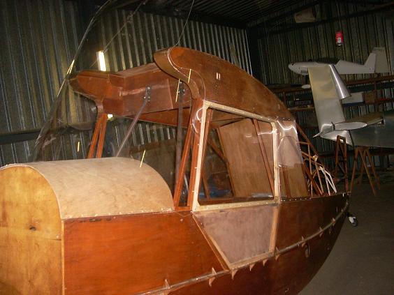

Postby Go Vert » Thu Mar 31, 2011 2:21 am

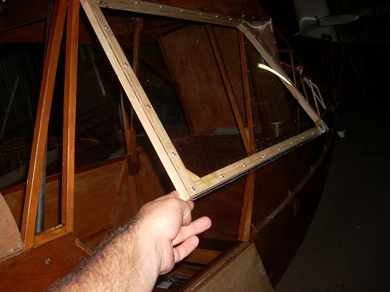

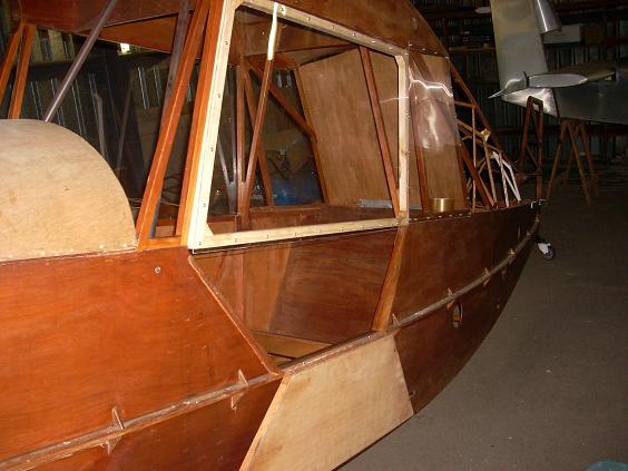

Shoewee what a night just got home at 2am :shock: some decentwork done tonight. All doors and window cut pre fitted and the final fit all done. Also skimmed 2.5mm off of the bottom and front/back of the door before I did the window for it. I need to get a heat gun tomorrow and heat the plexiglass slightly to get the top bend in the front windscreen then all window work is 100% complete.
