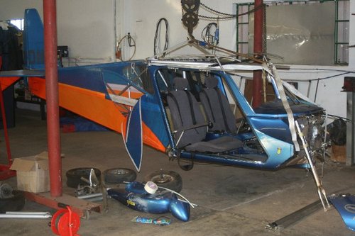

Right started stripping this morning and basically took the front bodywork apart. Still at this point I have found the one bent wing bracket and the Right top fuselage longeron pipe that is bent, Apart from the damage to the cowling and spats fibreglass the cabin fiaring has absolutely no damage. Rest of the fuse also undamaged. We are taking the whole thing apart though just to be sure. Will also give us the chance to refresh any worn parts and clean everything up. Pics from start this morning to where I stoppped.

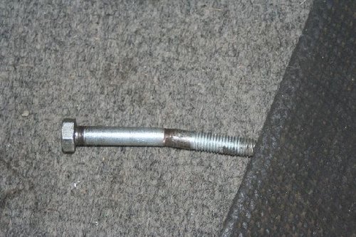

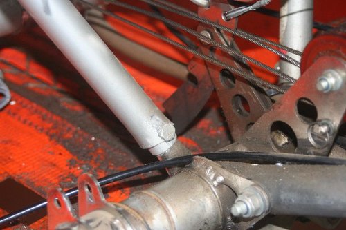

As for normal wear type items on a high hour cheetah- well the only thing we have found worn is the lower stop bolt on the nose gear. Except for the fact it was bent in the accident it has some serious wear.
These are the items I have found so far. first the stop bolt - look at the wear around the shaft. This is the main bolt that takes the rebound when the landing gear extends.

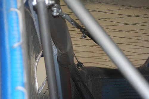

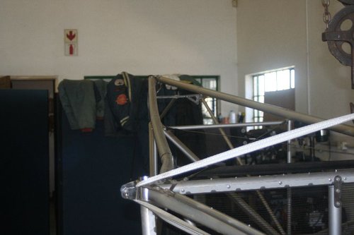

Next it the top righ rear fuse tube that got bent as the wing got pushed backwards and the last is the cross brace tube form the top right cab mount that got pulled out as that tube bent.

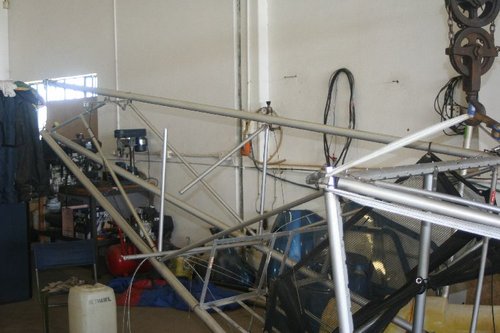

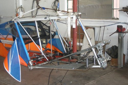

Right so saturday morning saw me stripping the rest of the fuselage to get the bent tube out and by saturday around 10:00 this is where we were.
Re: MY cheetah - ZU-DHH rebuild project
This is what I like about the Cheetah.You can repair/remove as you like because it is bolted together.
I think it is also stronger because it can "move/twist" as if it were welded it would crack.
