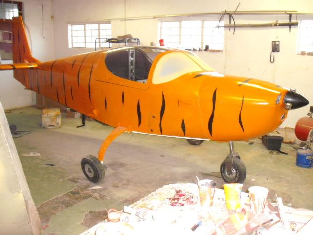

That looks stunning...where did you get the custom canopy set up from?
Where do I get one and how much is it?..this is a huge improvement on the existing XL canopy and I don't want to pay R20 000 approx to upgrade to a 650 canopy. Can you give me some details?
BTW Paint scheme is also pretty cool.

Well done doreen, she looks as if she is doing 150 standing still.doreen wrote:Keep up the good work. Quick peek at my scratch built xl.
Yes she looks just right.
Awsome job.

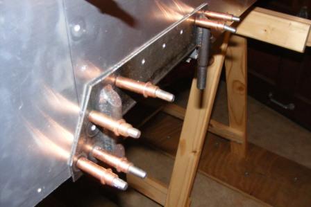

With the above in mind I headed back into the garage to trial fit the side skin and start preparing the gear attach plates for the spring leaf gear system. Just need to get one of my mates to hold the rear spar channel so that I can drill and cleco it on and then time to start connecting the skin to the gear attach plate through a set of uprights (may seem confusing but essentially a very simple exercise).
Until next time...
Until next time...
- Internal view - trial fit of side skin
- Side Skin Trial Fit.jpg (20.77 KiB) Viewed 7070 times
- External view - trial fit of side skin
- Side Skin Trial Fit 2.jpg (22.52 KiB) Viewed 7070 times
- Gear attach plate
- Gear attach plate.jpg (22.27 KiB) Viewed 7070 times

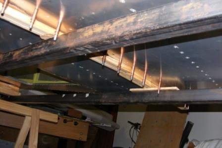

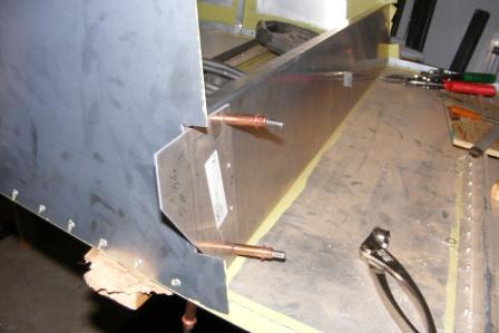

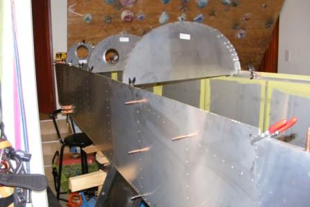

A couple of recent pics...installing the rear spar channels and wing attach points. j
- The underside view of the rear spar on beams
- Rear spar clecoed.jpg (21.58 KiB) Viewed 6991 times
- Cut out of rear spar attach brackets through side skin
- Rear spar attach brackets.jpg (20.84 KiB) Viewed 6991 times

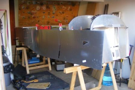

Re: Zodiac 601 XL Project

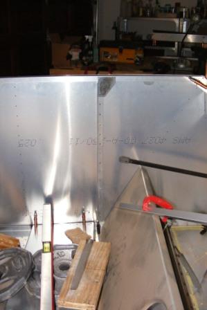

Did a bit of work over the weekend on the XL. The front side skin is finally secured after hours of fannying about with alignment...the area is starting to become rigid with the upper longerons now being secured, with clecos, to the lower longerons through the gear attach plate.
Also started on the the bulkheads for the rear fuselage yesterday so the kit is starting to metamorphose from a canoe into some semblance of an aircraft. It really amazes me how flimsy the structure feels in the initial build and as you brace the various pieces together it really starts to feel really solid (fortunately). A couple of pictures of the newly attached rear bulkheads (ie. the bit that supports the curved top skin that encloses the fuselage) will follow shortly.
That's all for now...enjoy your Monday.
James
James

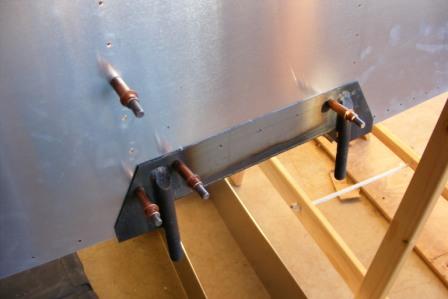

- The gear attach points cleco'd to the side skin
- Gear attach_July 2009.jpg (17.51 KiB) Viewed 6804 times
- The braces from the attach point to the upper longeron riveted together
- L Angle Uprights_July 2009.jpg (12.6 KiB) Viewed 6804 times
- Interior photo of initial bracing
- Interior Seat Back_July 2009.jpg (19.43 KiB) Viewed 6804 times

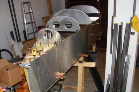

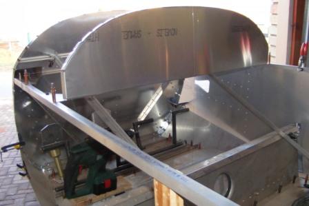

A couple of pics with the rear bulkheads in place....starting to feel like an aerie (almost)...j
- Rear bulkheads
- Rear Bulkheads 1.jpg (21.51 KiB) Viewed 6756 times
- Rear bulkheads again
- Rear bulkheads 2.jpg (24.71 KiB) Viewed 6756 times

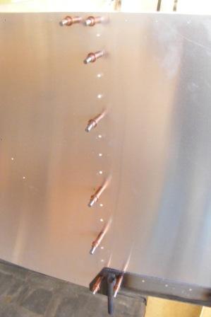

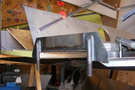

- Gear attach point
- Gear attach point close up.jpg (20.48 KiB) Viewed 6754 times
