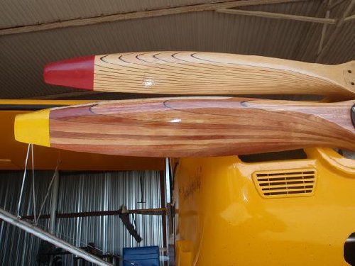

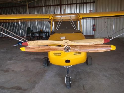

Did a testflight with the "new" prop. Much better performance.
Some pics of the old vs the new.

Aerosan wrote:Hi Paul
Hoe lyk dit? watter is die P Prop en watter is die POwerfin? Ek hoop om weer in die lug te wees binne die volgende twee maande, dalk kom kuier ek!
Cheers San
Soos KFA gese het. Die geel tips is die P-Prop. Ander een is nie die Powerfin nie, maar die Ritz wat op was. Powerfin is `n 4 blade composite.
Hoe het die composite vir jou gewerk?

Postby Morph » Wed May 20, 2009 11:04 am
What has the bigger prop done to your static RPM and EGT settings? Is the Prop at a higher, same, or lower pitch than the old one?

Morph,
It is a completely different setup. Used to be a 66x40 (the small one in the picture) with a 2.62 gear ratio. Static RPM was around 6300. She ran hot.
Now it is a 72x50 with a 3.47 gear ratio. Static RPM is 6500. Much cooler but I must add that I also changed the jets.

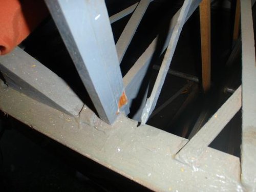

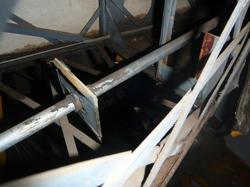

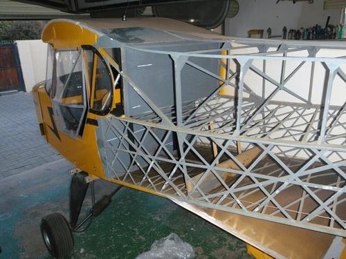

Postby Bugwar » Mon Jul 27, 2009 2:18 pm
Took WRH home to start the covering process.
Found some loose joints and one broken support. Will take all the skin off over the next couple of days to have a good look
She is currently one UGLY bird without her skin!! (**) (**) (**)
