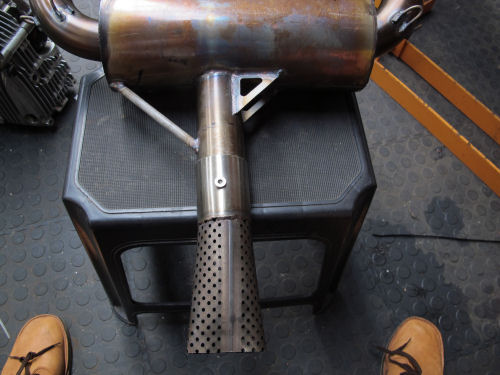

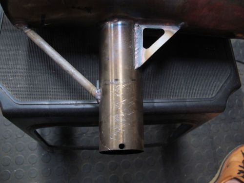

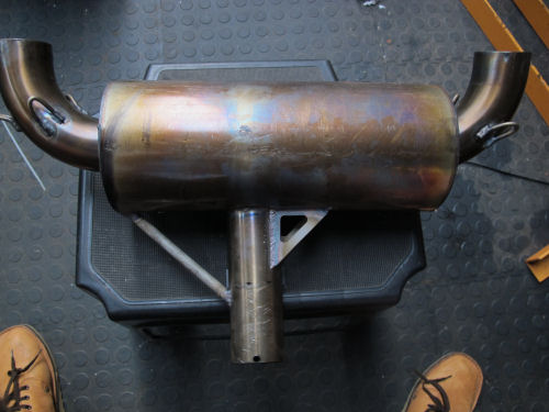

We had a problem with the exhaust of the Natal Bushbaby so I have number two of the latest exhaust series and spread the attachment area and hopefully changed the dynamics Time will tell so now for more hours.
Enclosed some pictures of the exhaust mods. I am also showing the added tailpipe which is detachable
Cheers Oupa-G

Exhaust tailpipe added
