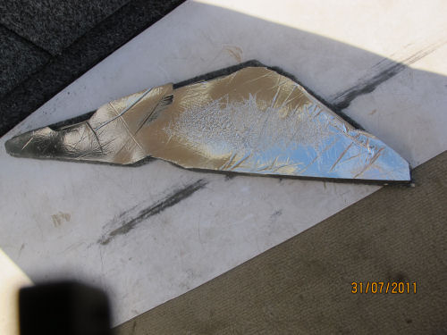

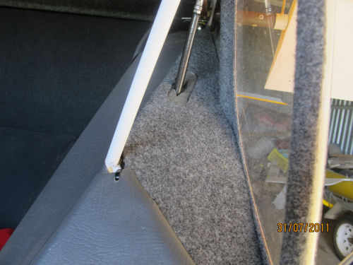

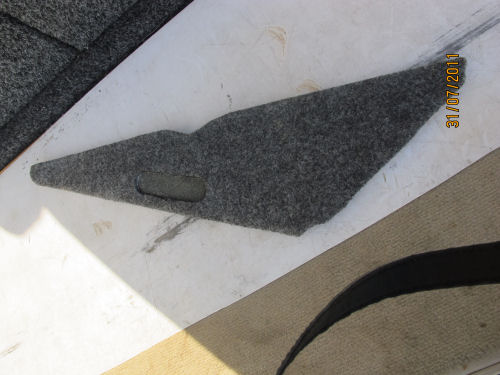

I today worked a bit on refinements I have made war on cabin noise here I'm just showing some padding on one of the panels , there is quite a bit of noise from the tailsection.

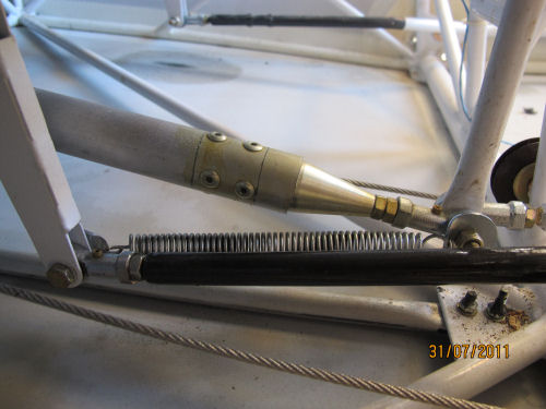

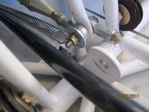

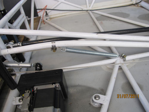

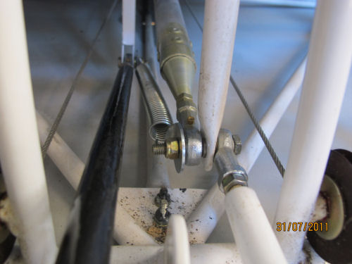

The other control refinement is placing a spring to give an up force on the elevator to counter act gravity force on the elevator. I used a big body washer one side it is anchored to the elevator and the other side to the flaperon lever. During test flying and testing the autopilot I found a need. The advantage is when the flaperon is deflected the centre of lift moves further aft which creates a considerable back force to be kept on the stick. The rear fixation of the spring moves further aft and the tension increases making the control lighter. An additional adjustable spring was fitted for fine tuning of control forces.

- Side panel with foam backing
- Panel1.jpg (40.98 KiB) Viewed 3759 times
- Noise insulation
- Panel2.jpg (42.29 KiB) Viewed 3759 times
- Control rod comes through foam slit
- Panel3.jpg (47.7 KiB) Viewed 3759 times
- Control spring
- spring1.jpg (44.92 KiB) Viewed 3759 times
- See on photo that one rod end is upside down oiling hole is pointed down wards
- spring2.jpg (39.3 KiB) Viewed 3759 times
- Different angle and different tension
- spring3.jpg (43.32 KiB) Viewed 3759 times
- Adjusteable spring for fine tuning of forces
- spring4.jpg (43.36 KiB) Viewed 3759 times
