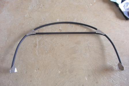

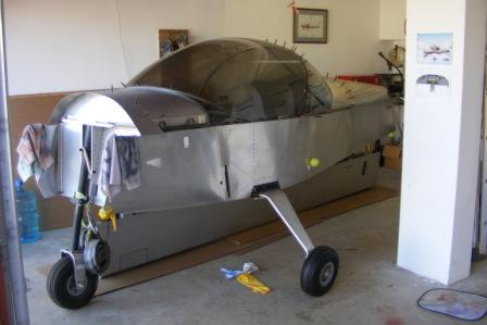

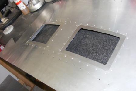

Postby Scotsman » Fri Dec 28, 2012 8:41 am
Manage to get back into building recently and put in a good few hours over Christmas.
used heat shrink rubber tubing to cover the canopy hoops which seems to have give a robust and good looking finish. Also decided that the kit needed to accommodate access to the rear of the instrument panel so fashion some access hatches....will secure the coverings to the hatches with rivinuts. Put together some wooden seat backs to seal off the access hole into the rear fuselage.
Latest picture
Compress_Latest profile.jpg (27.44 KiB) Viewed 9189 times
Access hatch constructed
compress access hatch.jpg (24.41 KiB) Viewed 9189 times
Covered canopy hoop
compress canopy hoop.jpg (24.91 KiB) Viewed 9189 times
