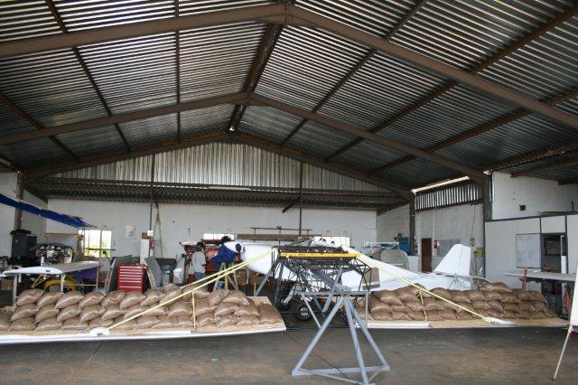

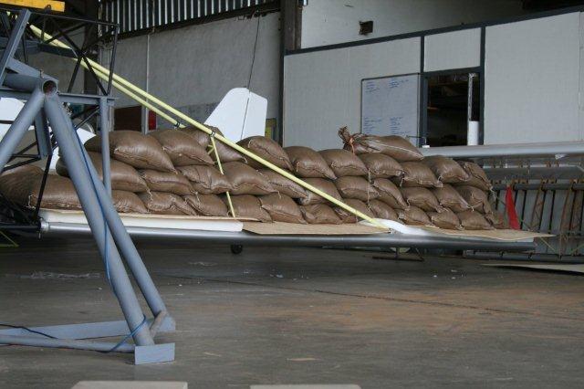

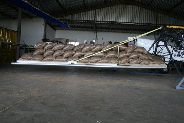

We did the Kitplanes Safari LSA wing load at the factory today. This was a test not whitnessed by CAA but it was for our own benefit. We loaded the test wings to a load equivelent to 600kg @ 4g. The wings performed flawlessly. Some pic's
Next will be the limit load test to 700kg @ 3,8g's and then after that the ultimate load to 700kg @ 3,8g plus 150%
Thanks KFA this looks magnificent these preparations making the jig etc etc etc to much to mention. I can now see the paperwork is looking at me on the horizon and it will make the waiting now sweet knowing the strength of the airframe.

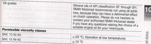

On the spot Justin. A newer specification, is not nessacirily the better specification for an older engine. If a SG oil is specified for an engine by the OEM - better to use the SG than the SL.justin.schoeman wrote:There is one important thing to remember though - oil grades are not always backwards compatible.
E.g. from my 2010 Gs 800 owners manual:
