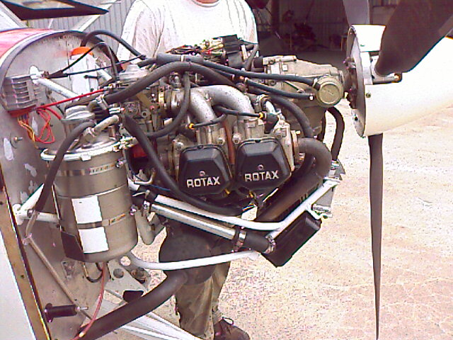

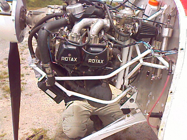

When I flew EPH back from Loeries we landed at Saldanha and noticed the one bracket on the radiator had fractured off. The radiators (Water and oil) were fastened to the front of the engine. I repaired it there and flew back to Morning Star. An hour later the other side fractured off.
I decided I liked to keep them there but we needed to hang them from the firewall instead of the engine. Also some the inlet pipes of the water radiator were very close to the front exhaust headers and the piped needed thermal bandaging to keep them from melting on the 800deg C headers.
So I took the radiator off and sent it to Silverton to move the inlet pipes outward. Ranger and I then spent last weekend fashioning up some brackets using 12mm, 1.6mm steel tubing. After Ranger welded and cleaned it up he sent it in for powder coating. Saturday we spent the day installing the radiators. They are now cradled solidly away from the engine.
Thanks to my mate Ranger for all the Help
PS Gadget quality controlled and wiped the fairing clean afterwards.
Proof that Gadget did something
Right Side
Left Side
