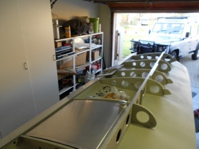

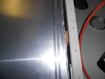

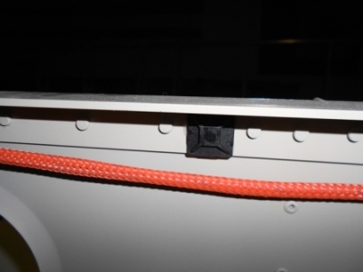

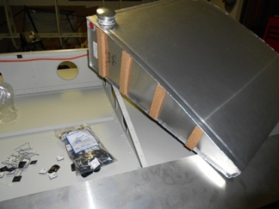

- Busy finishing off the wing but now have to install fuel tank, fuel flow sender and block off stupid extra hole in the fuel tank (still not sure how to do that) :shock: :shock: :shock: Once I have the fuel tank installed, I can close up and start wing # 2. I will strap the nose skin tonight and begin final drilling on the top skin (just remembered that I have to assemble my daughters pram tonight.......)
Snug as a bug
20110614 8.JPG (97.35 KiB) Viewed 18819 times
20110614 2.JPG (91.38 KiB) Viewed 18819 times
Cork ensures no rubbing or friction spots
20110614 4.JPG (94.99 KiB) Viewed 18819 times
Epoxied cable tie mounts to the spar
20110614 5.JPG (92.25 KiB) Viewed 18819 times

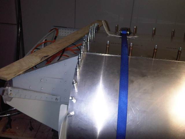

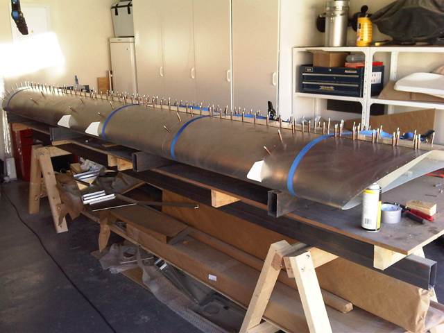

I have finished bending both wing skins and have drilled all holes to final size. Now to strip, debur and re-install. I am not rushing at the moment as I need to buy my nav lights before I can finish and its flipping cold at night in my garage!!!!! :lol:
All Done!!!

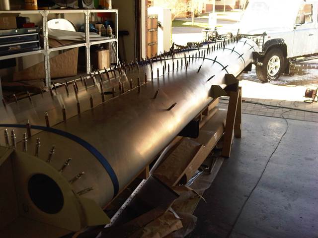

Wing skin finished

Still need to figure out if I should drill the root skins to size.
Cross_Wind
Challenger II LS ZU-FCP
Duck Rogers
Posts: 2318
Re: Conrads CH 750 Project
Postby Duck Rogers » Mon Jul 04, 2011 1:28 pm
Drill them (root skins) to size but don't trim. You do the trimming once the wing is on the plane because it's where it touches the roof of the cabin that matters. Once the wing is fitted you'll see nicely where to trim.
