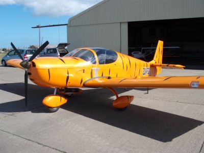

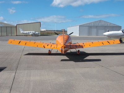

Sorry for the hijack but you might like this photos. I bought a transponder on e-bay, hope it works, that will be the last of the interior work. Will start with the fine tuning of the engine shortly.
ch650-1
ch650-2

No hijack...inspiration rather. I see fro the infamous unpainted "t" on the fuselage that you did the upgrade.
The aircraft looks awesome. When do you think that you are going to start doing flight testing and what category did you register it as on the build application (still haven't submitted mine)?

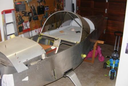

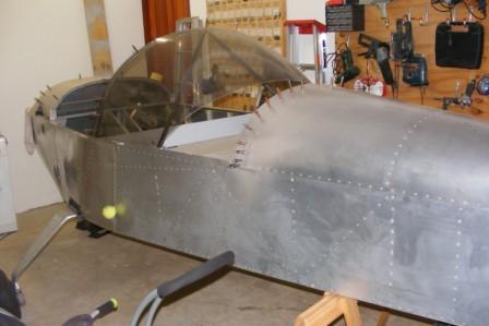

Postby Scotsman » Tue Nov 29, 2011 8:59 pm
Still not much progress to date...but thought I would post a couple of photos to make it look like I have actually been doing something. vhpy vhpy

Re: Zodiac 601 XL Project
Postby Boet » Tue Nov 29, 2011 9:09 pm
It`s not the canopy glass that is the problem. You need to sharpen your drill bits in a special way, otherwise cracks results. To drill metal etc, you sharpen the drill, so it will "digg in", exactly what is not needed when drilling plexiglass. IE, how to ruin a R5k canopy glass in seconds. Just grind the Cutting edge of the drill bit "blunt". so it will scratch through, and you will have no more ^$#%$@#&^&*. vhpy
