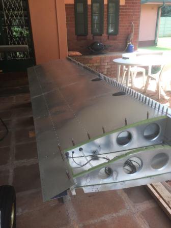

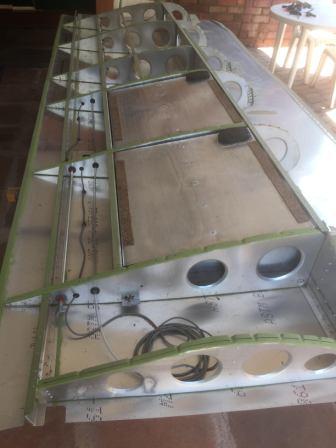

Postby Z-MRP » Tue Apr 25, 2017 12:33 pm
97A Left wing upper skin riveted.jpg (20.02 KiB) Viewed 26232 times
97 Left wing tanks,wiring and pitot line fitted.jpg (20.9 KiB) Viewed 26232 times
Build update. Wing spars have been inspected and passed so a huge leap forward on the construction of the wings.Tanks fitted and plumbed in along with nav wiring and pitot tube tubing.
Busy working on closing up the wing tips along with a mod to fit a hatch in the wing tip panel to access nav wiring and create a small storage/baggage space.

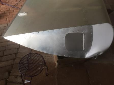

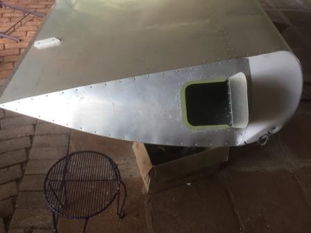

Postby Z-MRP » Mon May 08, 2017 11:46 am
97E Left wing tip storage hatch.jpg (19.68 KiB) Viewed 26161 times
97D left wing tip storage hatch.jpg (20.97 KiB) Viewed 26161 times
97B Left wing completed.jpg (34.06 KiB) Viewed 26161 times
Left wing completed as well as adding a storage hatch in the wing tip.

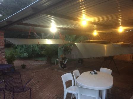

Postby Z-MRP » Mon Jul 17, 2017 10:31 am
98 Fitting the wings.jpg (27.77 KiB) Viewed 26061 times
Wings are now fitted. Dihedral is set now to start making up the wing struts

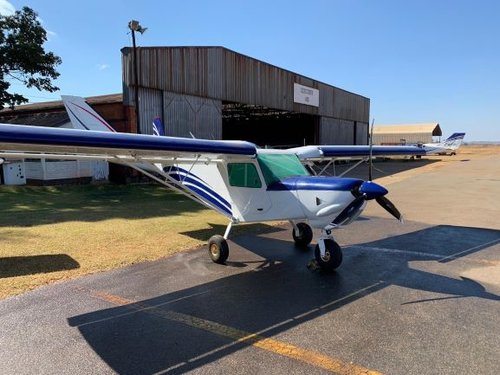

Postby Z-MRP » Mon Jun 08, 2020 5:38 pm
