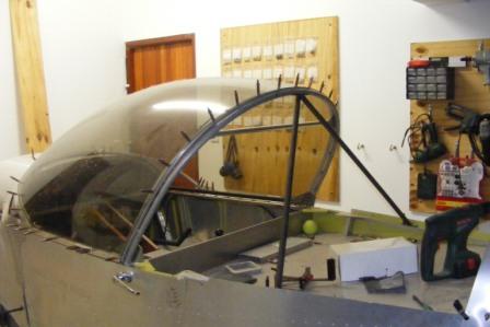

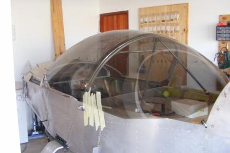

Well after a long lay off I have finally started to build again. As you can see from the photos I have been trying to mould the little guy into flying from an early age...hopefully it works!
After more hours than I would like to admint attempting to get the rear canopy frame/hoop to mirror the one in front of it, I have finally managed it. It was essentially torture as each bend does not always have the expected result. Even the manufacturer admits that they need to simplify this element. After that the welded assembly "roll over" bar (I wouldn't want to take my chances with it though :roll: ) was fitted quite quickly earlier today with a couple of shims.
A bit of trial fitting of the rear canopy after that and them trimming out the excess (and cracked area) with the dremel which went fairly well. The last photo shows the lay up before trimming and it gives you an idea of the scale of the bubble....serious viz. Feeling quite motivated now that we appear to have passed the tedious hoop bending stage. :)
The new little guy/co-pilot.
Rear canopy hoop finally in place.
Laying up the rear canopy before trimming.

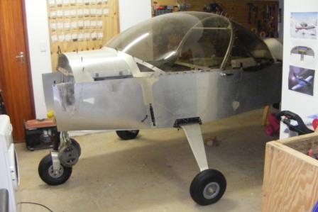

Drilled the rear canopy to the rear frame today and started trimming the side to fit...starting to come together slowly. Lots of fiddling around to get things right though.
Side view...
