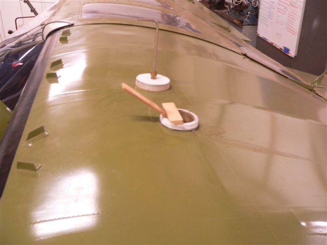

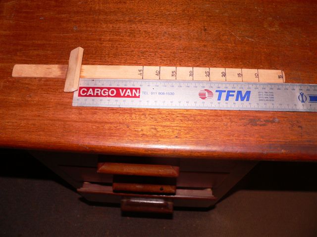

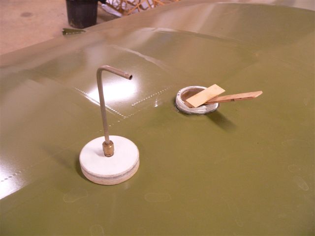

Love your fuel cap spanner. My cap was turned smooth on a lathe and I had to use a large visegrip to open or close due to the binding. I put on a little copper slip on the threads and it now easily turns by hand and seals nicely. Guess it will wash off over time, just add as needed.
How do you measure the fuel level in the bottom /rear of the tank with a vertical gauge when standing in the tail dragger position.
I made a gauge as per the attached pics and it shows the fuel level down to the last 5L. It makes very little difference if the plane is not quite level.
Very sad about your rudder damage, but we Bushbaby owners are now forwarned. My spring is also very sloppy. Need to change before it happens to me.
Happy flying.

Very clever mine was only for the full half part. I will definitely construct something like that, I'm a great fuel dip believer. I absolutely love the cross pollination on the web. The exhange of data is stunning. I can imagine that your dipstick will be very accurate. Thanks for the tip.
