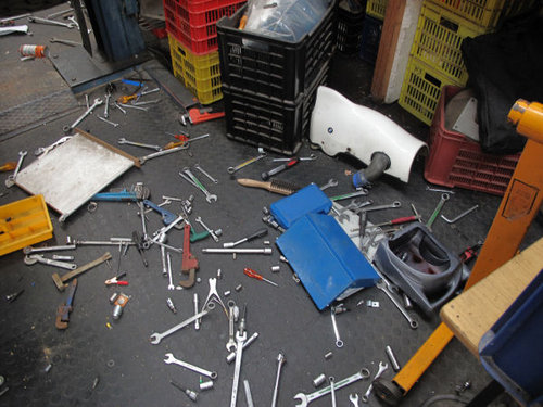

On closer examination the damage is much bigger then meets the eye. there are cracks all over the one side and the whole one side wall will have to be rebuilt. But nobody was hurt and it is just inconvenience. Half my workshop will be out of action for a long while. I'll have to move my computer fax etc etc ISDN line and such troublesome detail. Hope to do some flying because I'm going to Pemba next week for a week. So it will again be quiet on this site. Just some photo's of a scene in a quiet suburb.

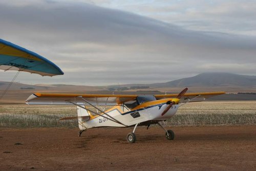

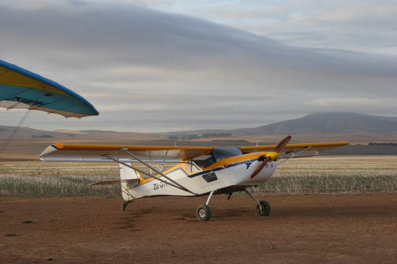

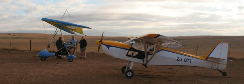

Well oupa is on his way to Pemba. He did manage to do a flight this morning and asked me to post these photos. He is very happy with the engine and it runs very smoothly, even sound better than the previous one but maybe it is just our imagination...
