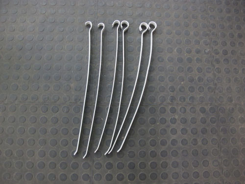

It is unbelieve-able what they come up with but we move on. Meanwhile aircraft are still running out of fuel so I have concentrated on a fuel dipstick for all the taildragger Bushbaby's with 50 lit main tanks. I have calibrated the dip sticks and all my friends that have taildragger aeries are getting one for X-Mas
I have taken the precise dimensions and will give this to the community to use.
Tonight I will just show the foto's and tomorrow I will give the precise measurements
Cheers Oupa-G
Cheers Oupa-G

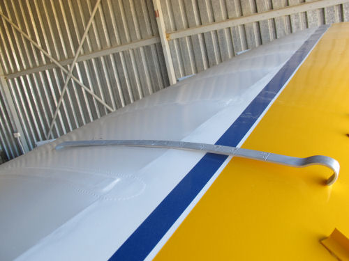

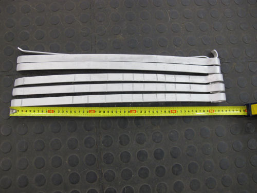

On the topic of the fuel dipstick I have the habit of checking my fuel with a dipstick before every new day and even after a long flight. The benefit is that you know precisely what your consumption is any fuel pilfering and if something changes. You should always know how much fuel is in the plane. Also you know which tank the plane favours. If you have a header tank system and you run the header tank dry your engine will stop and the engine will not start again unless you have electric booster pumps that can quickly fill the header tank.
The calibrated dipstick is the answer. For the 50liter wing tank of the Bushbaby I make the dipstick out of aluminium strip 19mm wide and 3mm thick the contour bend I have taken the curvature of the wing. Then it slides easily in the tank right to the back.
The dimensions are as follows:
0 lit=30mm
5 lit =160mm
10lit=195mm
15lit=235mm
20lit=270mm
25lit=295mm
30lit=320mm
35lit=353mm
40lit=372mm
45lit=400mm
50lit=440mm
Total lenght of dipstick 500mm the surface is beadblasted so the fuel can attach I first treated the surface with 600 grit waterpaper which worked but Boet suggested beadblasting it is quick and works well and I have a beadblaster.
This is only valid for taildraggers I calibrated these dimensions on a level floor and found them to be practical accurate.
This I then correlate with the fuel burn on the Stratomaster. One should then not miss manage the fuel. It is not called "motion lotion" for nothing
Cheers Oupa-G

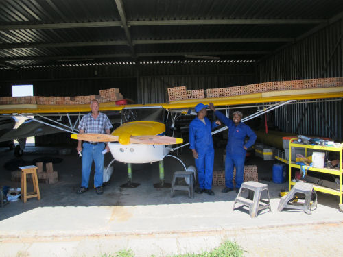

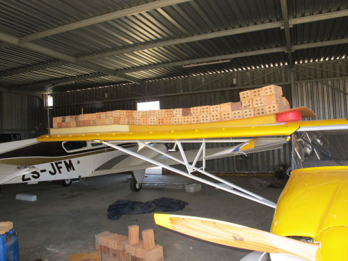

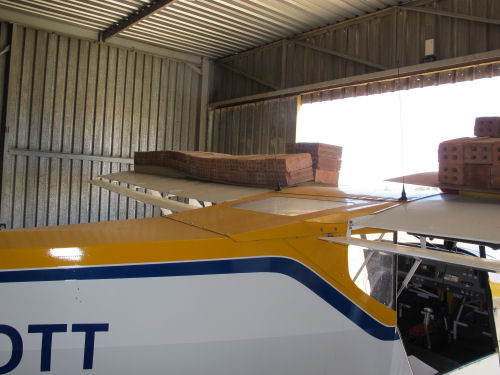

Today was a good day it all started when Braam arrived as arranged at 1 O'Clock we had a bite to eat and then did a tour of my workshop and proceeded to the hangar and there we measured the wing and then packed 123 4.1kg bricks on top of the foam mattresses which had a hardboard layer on top there were 4 rows of thirty bricks plus another 3 bricks to make up the full amount. When you pack this amount of weight on the wing you must not be faint hearted. It is however a very nice feeling if the wing takes the weight and only deflects 12mm that the construction is very sound. I am very proud of Boet's very fine construction method's they are the best in the industry. I tested the controls and the flaperons and no binding under full load.
I will definitely go through turbulence with a comfortable feeling. This plain is strong. In this test all struts are in compression except the roof structure. I can see that she will easily take 4G positive this will be done during the flight test. Meanwhile Braam noted all the figures as was laid down by Francois from Aerostruct and approved by Aarti.
Sean saw to it that all the paperwork was filled in correctly and he did the final inspection again for the third time. ZU-OTT is now legal at 600kg's AUW and the corresponding paperwork will be duly issued. This has been a long haul on a road of misunderstandings duplicating certain tests but I must say I had a deep feeling of satisfaction to know this wing is very strong.I will later explain in detail why things took so long.
I do not fore see any further hassles, over the weekend I'm again loading her this time without jacks so that the weight is on the undercarriage and if I do the same loading the gear will be loaded 2.6g's That should take care of the gear testing and the EboXi's I know work well. I will be able to concentrate on fine tuning the map and then my little Porsche which has been waiting will be tackled.
Enjoy the foties
Cheers Oupa-G
Enjoy the foties
