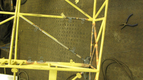

Today worked hard driving to hanger and back measuring shaping running the Banana boys EboXi, and tonight I have the final mounting plates with the servo's mounted. I turned six spacers on the lathe and tapped the holes . Tomorrow I will fit the spacers onto the lugs that I had already welded in on the airframe . Then I will position the plates mark and number the lugs and then the welding ,then it should be a custom fit. The autopilot was planned from day one and I was waiting for the MGL autopilot I'm enclosing a fotie from the airframe welding, the attach points can be seen. That is all for tonight.
