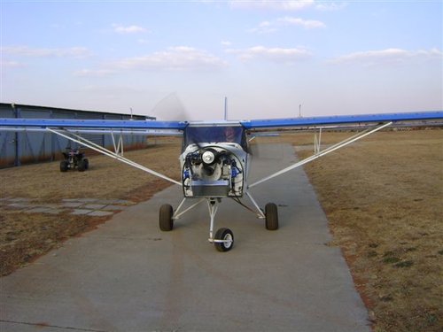

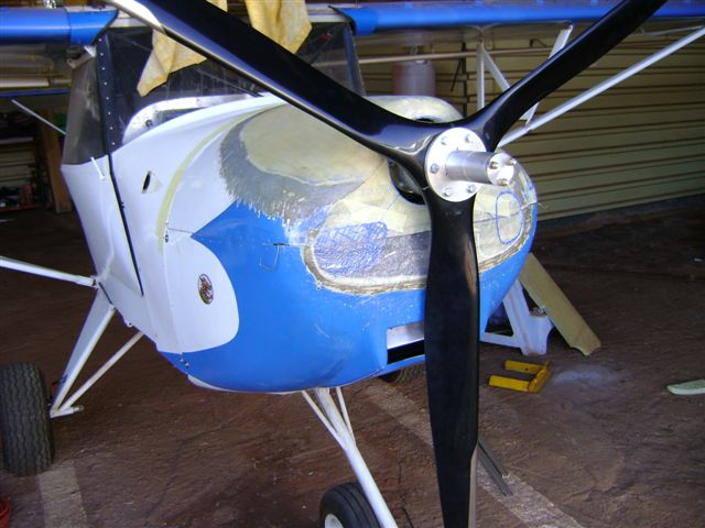

Ok guys
here is a couple of pics from the week end. We are getting close now and I hope to finish the cowl`s glass work on Wednessday and then do a final weight and balance.
I foresee that we will be able to fly this baby by the end on the year (**) ($$) (^^) Im aiming for end of next month though but end of the year still sounds fine to me, and the Duck still needs a rating ($$) ($$) ($$) puff

Re: Explorer
Postby Boet » Mon Jul 26, 2010 9:53 pm
Sanna, dis ekke wat by CFD gekuier het en op sy komper geskryf het oor die spinners. vhpy Jou errie begin lyk mooi! (^^) (^^) (^^) (^^) (^^)

Postby Aerosan » Mon Aug 23, 2010 7:24 pm

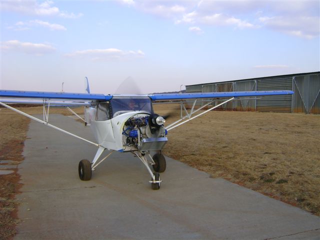

Just a small update...
We did a weight and balance this weekend, she came out a bit nosey...so we moved the battery back, gained 1 kg in weight due to the extended battery cables but she`s on the numbers! Between 21.47% to 25.82% with 100 kg pax and 100kg piloot. She is a bit heavy at 368kg empty :oops: but nou ja ons sal maar sien :P

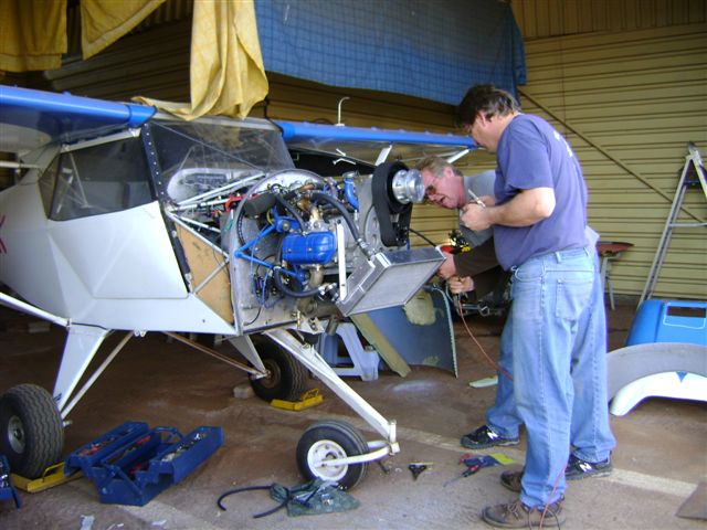

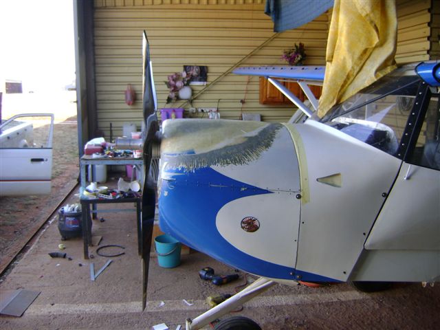

Unfortunately, some of us are heavier than others (no names, just follow my eyes! :roll: :roll: ).......And the bloody cowl just don't want to get finished :!: vhpy I keep hearing about how it's gonna get sanded down etc. but........nothing! niks!...still looks the same, week after week :lol: Maybe it was just a rumour :?:
I'm done welding the radiator and routing the waterpipes. Unfortunately the one weld on the radiator had a small leak and I had to take it back home to re-weld :oops:
This Sunday I'll be putting in a solo effort as some of us ( no names, just follow my eyes :roll: :roll: ) are slacking it somewhere on a farm, apparently attending some very important wedding (that's his version anyway!)
