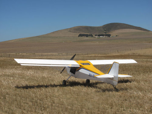

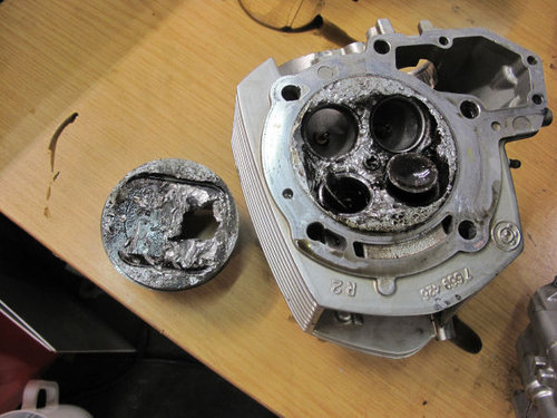

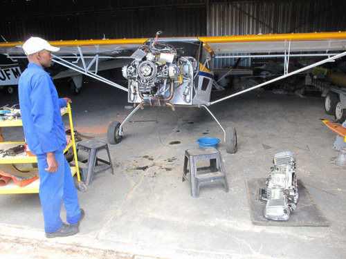

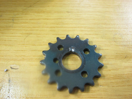

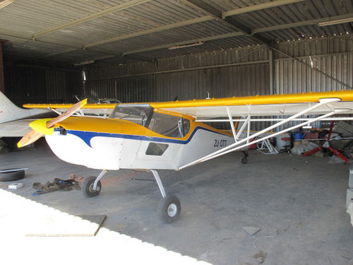

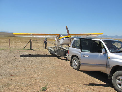

Sorry I have been off line ,but Saturday morning I filled the Bosvark full of fuel and was off to do the fuel consumption tests. Two minutes in to the flight I had planned on a cruise climb I was 700 feet agl when a funny noise came from the engine with serious power loss, Changed to the backup system, put the fuel pump on with no change the compulsory landing was due in the imminent future. The gear absorbed the wheat field surface. The Bosvarkie side slips like a dream and it was very easy to plan the precise position to land no floating. I ended not putting a scratch on the machine. Cel phone came to help and I soon got a lift back to my hangar and collected the Cruiser and my trailer and brought the Bosvarkie home in one piece through the farm gates from wheat-field to wheat-field till I was at the hangar an absolute non-event. The sudden stoppage puzzled me so before I came to any funny conclusions I quickly swapped engines and brought the engine to the workshop. When I pulled the cylinder all the screws were loose and there was evidence of somebody that had previously worked on the engine, the sprocket on the camshaft was loose and the valves got out of sync and BINGO. The lesson: I will not accept an engine without full inspection. The engine that is in the Bosvarkie now I have rebuilt personally and I have checked at every level, it was the engine I had the detonation with and I have brought the engine to GS specs with low compression pistons and the GS camshaft. Here are some foto's long overdue.
Cheers Oupa-G

On trailer through farm gate

Back in hangar no scratch

Engine swapped

Some metal fruit salad

The camshaft sprocket with the deformed key proof of the origin of the engine stoppage
