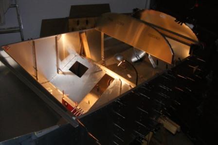

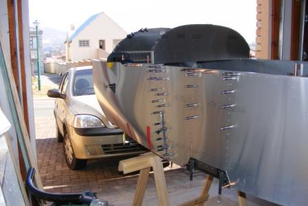

Got stuck in over the last week attaching the side skin to the main spar attach carry through and starting putting in the curvature of the front side skin where it attaches to the firewall. The curvature has been reinforced by straight L angles and some crimped L angles. After clecoing the side skin to the firewall on one side the angle of the firewall is finally set at the require 77 degrees (previously it was only clamped in place and every time I knocked into the aircraft I would have to reset the entire balancing act).
Anyway I have attached some pictures to give you some idea of the level of progress.
Cabin interior prior to bracing showing the curvature
Fuselage interior.jpg (19.61 KiB) Viewed 4937 times
The exterior view of the curved side skin
Fuselage Side Skin.jpg (23.34 KiB) Viewed 4935 times

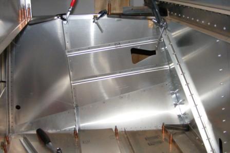

The forward element of hte fuselage is really coming together with all the side bracing (l angles and extrusions) cleco'd in place. The start of the seat (ie. the angled panel with the rectangular holes in it) have been cleco'd into place. After finishing some other bracing/channeling I have placed the baggage shelf (just behind the seats in place) temporarily pending cutting some more holes for further channels and placing some additional bracing.
My first Hosten control stick arrived today with several buttons for integration into other controls such as aileron trim, elevator trim, flaps, PTT etc. The build quality of the stick looks really good and I will trial fit it tonight to see if I either need additional bushings or whether the core needs work on a lathe.
Building the seating interior of the aerie in the evening
Picture 011.jpg (26.47 KiB) Viewed 4848 times

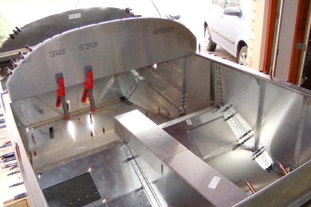

Well since the last photos there has been a fair bit of progress. In the cockpit section I have assembled the centre armrest section, flap actuator hinge, seat belt securing points, seat bottoms and the aileron torque tube. The latest interior shot shows most of the recent progress in the cockpit.
The assembly is currently cleco'd together and I am getting near the rather tedious task of stripping the assembly, deburring, preparing for priming, priming, reassembly and final riveting. Unfortunately I have a list of "to do" items that need to be finished first including the LAA spar modifications. Pretty happy with progress at the minute as I can see the aircraft coming together now.
Latest interior shots.
