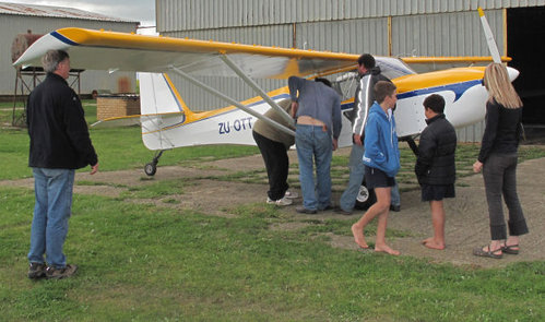

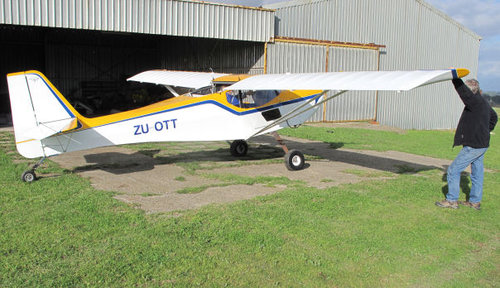

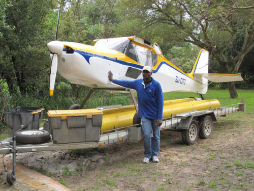

This weekend very busy took the Bosvark to its own hangar sharing it with the Baron. Finished all the connections in the left wingroot also in the evenings I wrote the preliminary handbook which will be amended after the test flying. Did not take to many photo's but that I will do. Did do some taxi tests the CoG and gear position feels 100% the brakes are excellent I could hold the brakes and lift the tail and turn it stationary. I could do the same with the J3 Cub that I once owned. Just some photo's of the weekend. Not on the last picture all the helping hands Sean Curren supporting wing ala African style Charl Starke putting in lift strut bolt closely checked by Ystervark. All hands were on deck as well as moral support by every-one. I also see that the 43000 hits have been registered hard to believe thanks.

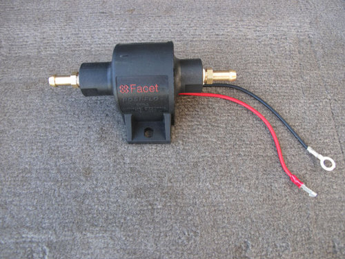

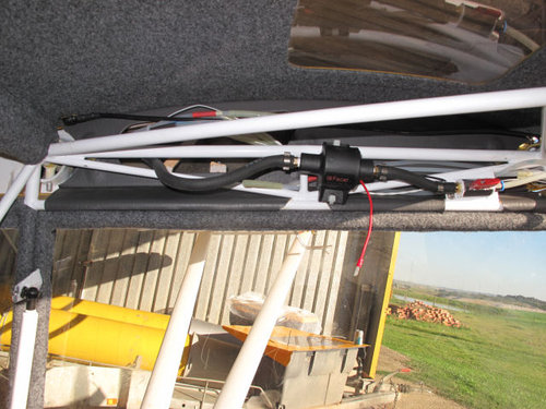

Have been extremely busy this week day work after hour work and little Bosvarkie work. But during the week I sneeked in a few hours checking the fuel flow. To start of I was very dissappointed I could get no spontanious flow with 20 liters in the tank the routing is such that there is a higher point due to the high angle of attack on the ground 10 degrees. This is something I cannot tolerate, with the right set of circumstances you could use up all the fuel from the header tank and then run out of fuel , not safe. Luckily Facet pumps with their new PosiFlo range have a pump that pumps well and when not pumping has a free flow through it. I fiddled today with placement of the pump and now the result is super. I was just informed about Mike and James ariving safely in Hawai what a magnificent achievement we must all congratulate them. Back to the fuel flow, the Facet pump starts the flow like starting a syphon. Under syphon flow I get 1.5 the amount of flow that I need at full power. The flow is 45 liters/hour in free flow for one side . The BM engine uses 30 lit/hr so it should be enough just running on one tank. If taking off on both tanks fuel starvation should not be a problem. If I let the fuel pump run all the time on one side the flow increases to 120l/hr. So now I can finish the wing roots and complete the wing assembly. Just some photo's on the pump and fuel flow test.

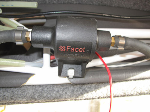

Postby Oupa-G » Sat Aug 08, 2009 5:43 pm
Just another picture of the pump in position giving more perspective. Buiding time wise the project is not yet one year because
