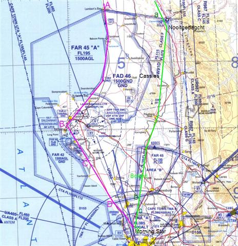

Airspace wise refer to the pic. It gives two routes, one via the coast, and one following the N7 if you get mist
The whole northern sector is on 124.8 below 1500ft agl. Above that Cape Town Information 126.5
Coastal route.
A. At Lamberts bay you enter FAD46 (below1500ft) and FAR 45 "A"(above 1500ft agl). Both of these require you speak to Langebaan Weg 122.5
B. Within 3nm of Saldanha call Langebaan and tell them you are changing to 122.7(Saldanha) then broadcast for Saldanha 122.7 (uncontrolled but can be busy)
on the way out change back to 122.5, and request clearance for Morning Star. Route over Langebaan and stay east of the lagoon. Don't fly over the islands on the west of the lagoon. They are military.
C. at the Southern end of lagoon, call 122.5 outbound and change freq to 124.8 (<1500agl) or stay on 122.5 if above 1500ft agl. From here you can hug the coast
D. On the coast there will be a rocky outcrop we call Bokpunt, ahead of you will be Koeberg Nuclear Power Station. If you are west of the R27, 125.8 remain below 2000ft. The Mamre RD will join the R27 on the left. To the left of the R27, FAD 200, 124.4. Be careful of Delta 200 airfield. This is a skydiving airfield and is quite close to the R27 and there are always meat bombs dropping out of the sky. I suggest you hug the R27 until abeam Koeberg and then follow the Powerlines in to Morning Star.
The N7 route.
This would follow from Vredendal to Clanwilliam, Nooightgedagcht, over the klippe and Cassies place, Piketberg, Moreesberg, Malmesbury and Morning Star
a. At Clanwilliam you enter FAR 45 "A". Below 1500ft agl 124.8, above 122.5 Langebaanweg
At Moreesburg you enter FAR 45 "B". below 1500ft 124.8, above 1500ft and below FL120 126.5 Cape Town information. Above FL120 122.5
b. Here you cross into the FAD200, 4000ft and below 124.4. If you prefer to route to the east of Malmesbury then you enter TMA "B" and you MUST remain below 4500ft, 124.8
c. Crossing over the N7 takes you into TMA "B" 4500ft max or "A" 2000ft max. 124.8
Morning Star, All circuits to the east of the N7, 02/20, 200ft AMSL, 650m, tar. Tall blue gum trees on both approaches
Coastal route.
The N7 route.
