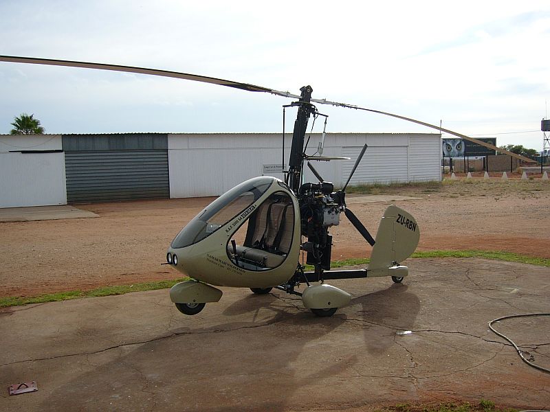

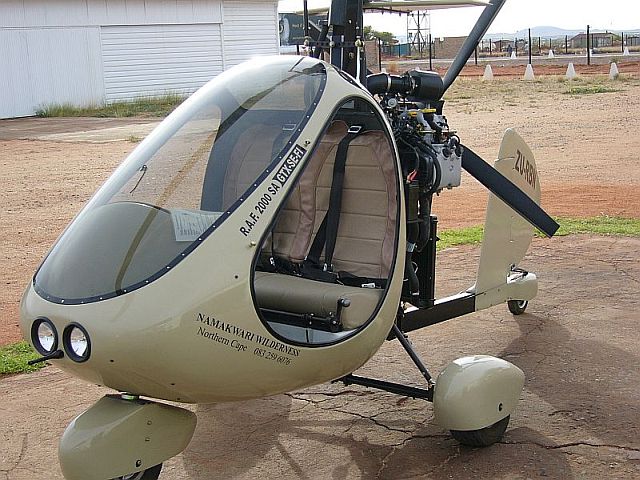

SOME MORE RAF 2000 GTX SE FI FOTOS
- RAF 2000 GTX SE FI 2.5 (FRANKIE).jpg (96.63 KiB) Viewed 4151 times
- RAF 2000 GTX SE FI 2.5.jpg (94.14 KiB) Viewed 4152 times

Am I being dof but aren't horizontal stabilisers standard issue on RAF yet?
What about PIO?
What about PIO?
ZU-f-ALL
Re: SOME MORE RAF 2000 GTX SE FI FOTOS
What is the Horizontal "Wing" just above the engine. Surely that will do the same work?

Nice photo Eben.
I see in the Sa flyer you have regitered 18 RAF's in one month.
Well done

Hi T
Thanks yes we did register 18.
