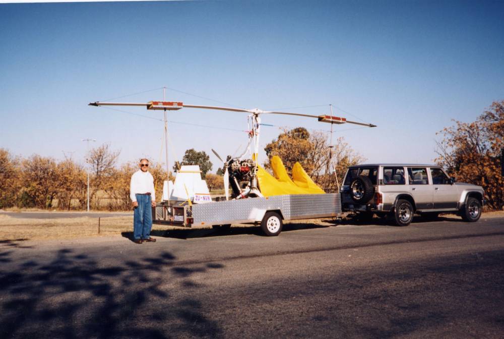

Did somebody out there “invent” a “safe” method to transport your Gyro on a trailer without taking off the blades. ? I know it is better to fly to your destination but if there is only one driver then it is a problem

Yes, I did.
I have done many trips like twice JHB-Upington and back, 4 times JHB-Hazyview, can drive up to 130 km/h with the blades on.
Some trailers came with a sort of support for the blades but this design is wrong as it is a knife edge that can crack your blades. Also the 2 supports have no pitch which forces the blades (which have an angle of incidence) on their trailing edge.

It looks like Jean Pierre and his old Magni, JP how's the new gyro build coming....

Can one transport a RAF like this? Is it stable?

In fact I did transport a RAF on that trailer. Obviously the wheel blocks did not match but that is to be adjusted when you build the trailer. Also the RAF is tail heavy without any pax. As you want the rotor blades parallel to the road for airflow reasons, I would force it on its nose with a tail boom upright support and that would avoid forcing the pitch control stops. When ready to be towed, you should in fact be able to move the stick in any direction although the blades are strapped as the mounting boxes are on rod-end bearings.
