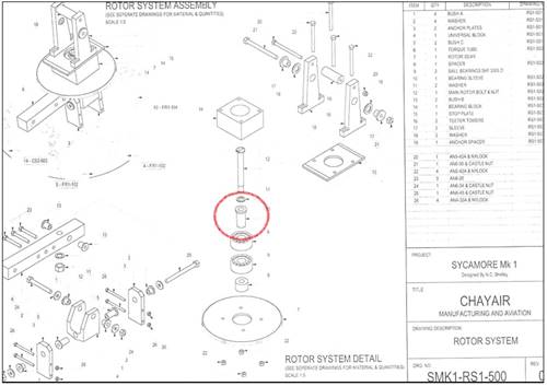

If I read the accident report correctly, in summary the owner had a new (non-approved) rotor-head machined and then assembled & installed it on the gyro himself. The accident investigation identified a number of manufacturing & assembly flaws, the major fault being that the bearing sleeve was installed upside down which resulted in "the rotor separating from the rotor mast in flight".
http://www.caa.co.za/Accidents%20and%20 ... s/8204.pdf
caa syc bearing sleeve.jpg (23.5 KiB) Viewed 14716 times
