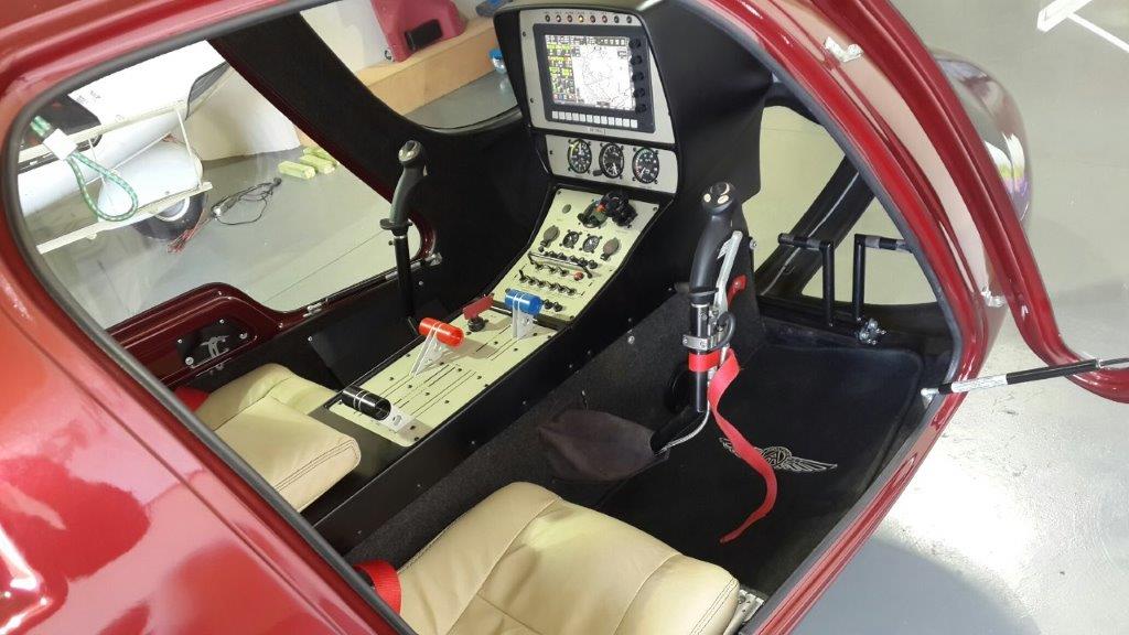

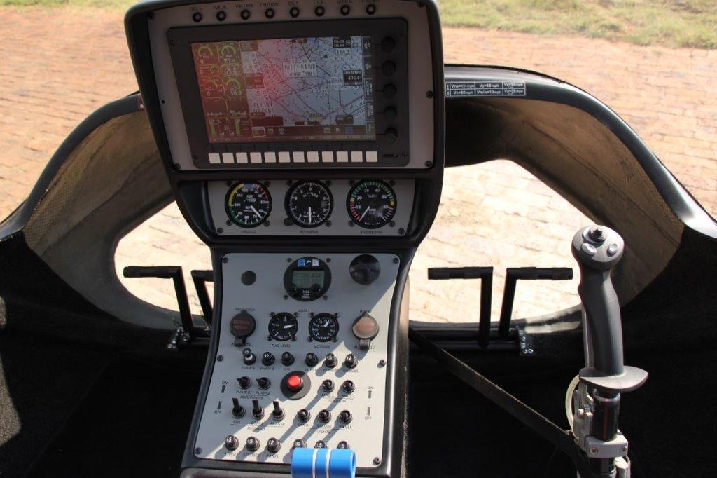

Greg
All the best with this. I for one will be watching this space/process carefully.

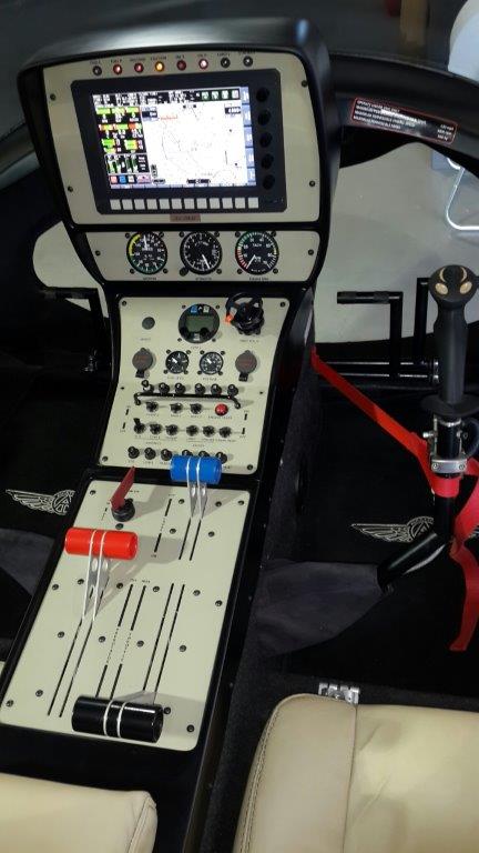

I revamped the interior and instrument panel in my previous Xenon and my current Zen.
The CAA mod applications process, their requirements for BCAR-T tests on the instrument panels to +6 / -9 G etc, etc, etc was absolutely ridiculous.
All I can say, all the best with this process.

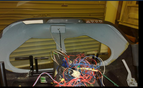

I don't believe the wiring on that machine is factory fitted, I think it has been fiddled with here locally.
We upgraded to pop-out fuses on our panels which you can isolate the No 1 Pump if you want to.

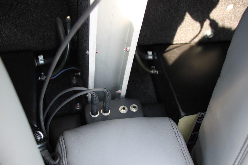

We moved the headset jacks in the centre console to behind the seats, just before the mast.
I think the overhead console will spoil your unobstructed view that you have in the Xenon.
I think you should check your pre-rotator system if you find it cumbersome. I can never understand why people want to add +- 5-10kg on a gyro for something that you use for +- 30 seconds of total flight time and it might save you 5 seconds on the runway. I also haven't experienced any lateral movement on any of the pre-rotator systems as you mentioned.
Obviously the electric trim is a must as it is standard on all new Zen's.
Anyhow, all the best with this.

Popped in at Greg's work shop today, unfortunately he was not there - I see the strip down of the xenon proceeds at a brisk pace. =D*
I trust that mess of wires will be sorted?!

XENON UPGRADE UP DATE:
admiring the freshly painted rims.
contemplating what we can add / allocate to the new multi button grips?
checking the new stronger pre rotator arm
it's got to be here somewhere.......
FAFK - ZUDMJ

The list : Pedals linkage, false floor for heels resting allowing tool compartment, Rudder Teleflex cables with rod end bearings, and complete redesign of angles between the nose wheel, pedals and rudders. The end result, very light on pedals and it can turn on a ticky. Complete new schematics as the recommended wiring had many flaws. 13 fuses are in the circuit compared to the original 5. Push one button and leds confirm all fuses. In those days, Xenons were losing their doors in flight, and according to the french boffin, it was a pilot error ! I made proper carbon fibre frames for the doors and designed the latches. Of course, gas struts.
Instrument panel clogging, like you noticed called for an overhead panel with all switches that are not used often in flight. Don't worry, it does not affect visibility. Like you have said, EFIS is an issue when it goes to sleep, and I currently have that issue, rarely but it is there. Recycle power in flight because the MGL hangs requires full trust in your "feelings" to continue your flight.
