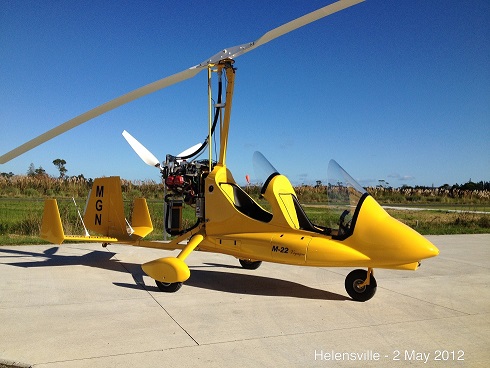

Here is my gyro in NZ - the ZK is not required, however the minimum height of the letters is 150 mm and there is also a minimum width. A belly registration is also required with specific dimensions. I had to apply for a dispensation in the height of the letters as the 150 mm each still wouldn't fit on the tail. Minimum legal flying height is 500 ft agl at all times other than when taking off, landing or in designated low flying areas.Steve_SP wrote:""It is also not possible to remove the ZU prefix as it is international regulation. ""
Somehow New Zealand has a concession - if you visit New Zealand you will notice that 80% of the aircraft at a GA airfield do not wear the national prefix "ZK" - they just wear the final three letters of the ZK registration.
example
http://www.abpic.co.uk/photo/1351092/
http://www.abpic.co.uk/photo/1350441/
I suspect it is due mainly to the fact that the islands are a long way from anywhere else and those GA aircraft are not likely to ( or even possible of ) flying to another country.
How many of the ZU registered aircraft in SA have any intention of operating outside of SA ?
Cheers,
L.
- IMG_0349.JPG (77.49 KiB) Viewed 6450 times
