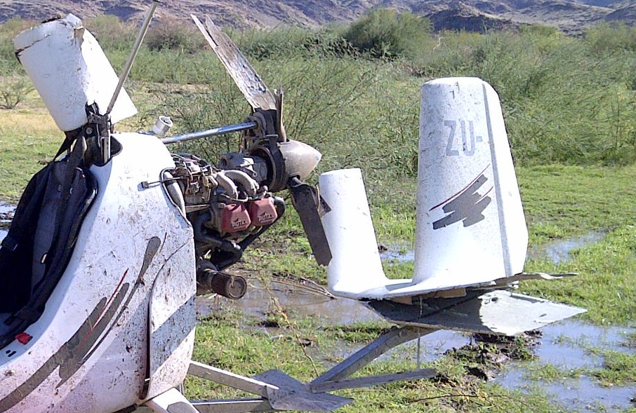

I don't wish to speculate as I am hoping that the pilot concerned will share his experience, but I doubt rudder control failure need result in it 'spinning around' ?
It will only spin around if there is torque. (or its behind the power curve in an uncontrolled hover) ... Prerotator engaged during flight may possibly do that.
From this picture found elsewhere, the rudder is still in tact after the accident so unless it was jammed at an acute angle, the worst that will happen is a roll which should be correctable with stick. No?
Pity this happened but thankfully nobody was hurt or worse!

Len,
I know this is probably not the right place for a post like this, but in the interest of continuity and for my own growth (and I am sure lots of other Gyro Pilots), what would be the typical indication and counter measure in the 2 x situations as described above:
1. Loss of a rudder - what will tell me that? Taking into consideration that some of us cant see our rudders
, and what do I do to counter that grave situation and get down to terra firma, hopefully in 1 piece;
2. Pre-rotator engages in flight - Again what are the indications and same for above.
I remember in April 2012 my instructor at Springs took out a student to the GF in an Ela and the prerotator engaged in flight. He described it as such a strong yaw and wanting to roll over that he asked the student just to concentrate on rudder input while he had to use all his strength the handle the stick and get the gyro landed! Scary stuff!
Pieter
