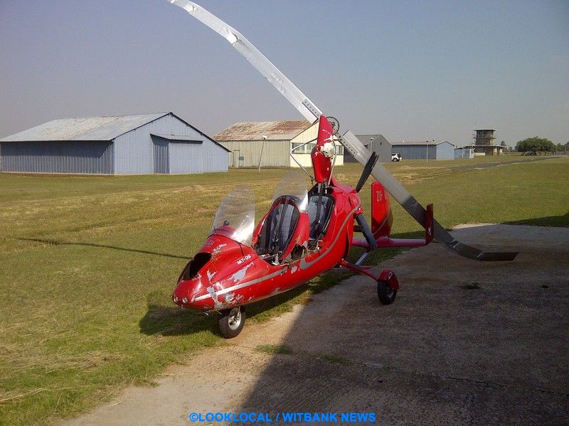

C205
Posts: 438
Joined: Tue May 24, 2005 7:47 am
Location: Witbank
Re: MT 05 Accident Witbank
Postby C205 » Fri Apr 20, 2012 7:34 am
Pic of the gyro
Quicksilver MXII ZS-VAP
Quicksilver MXII ZU-BOW
FAWI 123.5
Postby Gyronaut » Fri Apr 20, 2012 7:53 am
That'll buff right out :)
I look forward to hearing what really happened?
Engine was clearly running, judging by the damage to the prop.
Blade flap usually results in a roll-over to the left in counter clock-wise rotating rotors.
NOT Speculating, just asking.

Condor
Posts: 290
Location: Kitty Hawk
Postby Condor » Thu May 03, 2012 1:41 pm
What is the lesson from this unfortunate accident?
ROTOR MANAGEMENT, ROTOR MANAGEMENT AND ONCE AGAIN ROTOR MANAGEMENT.
The passenger in this accident wrote a "uitk$%&" letter to the factory in Germany to state how unstable gyro's are and something should be done about it.
I invite this passenger for a 10 min private discussion to understand the basics and then he will also understand that gyro's are NOT unstable.
I can’t quote every word of his letter but the facts almost clarify the whole story.
These are the basic facts from his letter:
The pilot did his checks and pre-rotated to 200rpm as per the book.
They started their take-off roll and at 70mph the pilot realised all was not well and discovered the rotor rpm has slowed down to 195rpm. At this stage he decided to abort.
The next moment the gyro jump in the air and landed on its side to skid along the runway for almost 70m.
Now we can just wonder why did blade-flap still tipped the gyro over.
Did the pilot pull the stick back to stop the gyro?
Did he...........
Who knows?
To me it is clear that a momentarily laps in pilot concentration (not pulling the stick back before take-off) caused this accident, which bring me to my opening statement of ROTOR management.
Postby Gyronaut » Thu May 03, 2012 8:33 pm
High Speed Blade Flap would be my guess. [so shoot me for speculating so shamelessly, I dont care :lol: ]
Statistically it is evident that the following is true:
#1 cause of gyro accidents: Flying into Wires
#2 cause of gyro accidents: Flying behind the power-curve (too low too slow)
#3 cause of gyro accidents: Rotor mismanagement on the ground
Fatality probability is higher the lower the number above.
Gyro's all essentially behave the same, no matter what the make or model. This is not about a specific manufacturer or configuration. All gyro's will experience the same given the same circumstances.

The higher the speed the more violent the flap. At 60mph the average gyro's rotor speed should be around 350+. Any less angle of attack to lift the machine off the ground at that speed is very risky. Remember gyroscopic-precession will happen 90deg later. In a counter-clockwise rotation system, high speed blade-flap will probably result in a roll-over to the left (I think).
"Decreasing the rotor disc angle of attack with forward cyclic (stick full forward) can reduce the excessive amount of airflow causing the blade flap. This also allows greater clearance between the rotor blades and the surface behind the gyroplane, minimizing the chances of a blade striking the ground."
This is basic stuff actually. If you understand the aerodynamics it can't happen to you. You wouldn't jump off a cliff with a half inflated para-glider wing would you? Open the 'chute' with the stick back, balance , hold, then take off safely.

mak
Posts: 556
Postby mak » Fri May 04, 2012 9:14 am
Len
I agree that a high speed blade flap is the most probable cause. Only thing that puzzles me is that the rudder and vertical stabilizer looks undamaged. Almost all blade flaps, according to me, chop the vertical stabilizer and rudder off before hitting the ground, or am I wrong? Can a flat rotor angle (as is the case with normal blade flap) prevent this.
www.altairaviation.co.za
Learjet
Posts: 664
Postby Learjet » Fri May 04, 2012 10:05 am
mak wrote:Len
Also noticed the vertical stab had escaped being chopped - this suggests that there was still sufficient rotor rpm to provide enough coning of the blades to clear the stab.
Blade flap could well have occurred - though it may not have been that severe. A contributing factor may be that the stick back to "brake" the forward roll spun up the rotors enough to inadvertently lift off and the pilot may have been caught completely off-guard - add some torque roll... BANG! rotor ground strike and over it went.
Whatever the case glad everyone was ok. vhpy

saraf
Posts: 776
Location: Upington
Postby saraf » Fri May 04, 2012 2:24 pm
Training and Pilot error...............
I do not see Blade Flap happening here, nor does the aircraft show signs of blade flap. ( Tail not chopped)
Training , Training, Training, Training, Training.....................
Postby Gyronaut » Sat May 05, 2012 9:18 am
um, remember Gyroscopic precession? Where are the resultant forces going to impact? Don't forget Newtons laws. "opposite and equal reaction" :shock:
It is a simple fact that when an outside force is applied to a rotating body, the result of the outside force will occur approximately 90 degrees later in the plane of rotation. :?:
Lets say the advancing blade changes angle of attack and flies (generates lift) violently at 3 o'clock. (counterclockwise rotating rotor of course). The advancing blade flaps up dead-ahead (Pushing the retreating blade down changing the apparent wind to that blade so that the retreating blade creates more lift but not as much as the advancing one causing disparity of lift. One blade flies more than the other, picks the gyro up and rolls it over. My logic says - If the apparent wind is dead ahead the tail may suffer otherwise it will roll-over sideways (to downwind).
Fluid dynamic/aeronautic experts can enlighten us perhaps?
