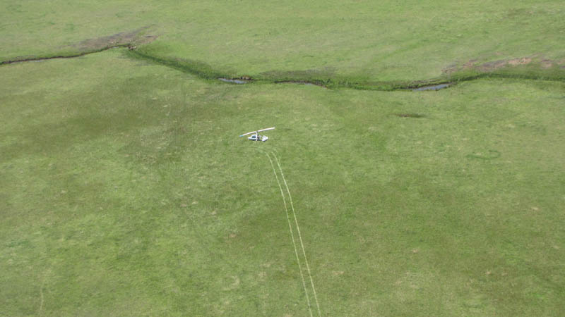

I took a passenger for a flip on Saturday morning at Kitty Hawk. Just after take-off I heard old no. 7 over the radio " Gyro down, CCN , searching ". I cannot describe what went through my mind. Fortunately about three minutes later Glen in RWW found them and related the news that plane and passengers are fine. He then did a splendid job circling, calling for back-up and hanging around untill they were picked up by the chopper. That's a feather for you in your cap Glen. :wink: Well done.
From the pic it might look like a non event, but I assure you Francois did a brilliant job putting the gyro down safely. After a lot of rain the past week, this area where he has put CCN down, has some very wet patches. They were also very lucky, cause there is literally hundreds of power line pylons in the area. =D* =D* =D*
CCN
