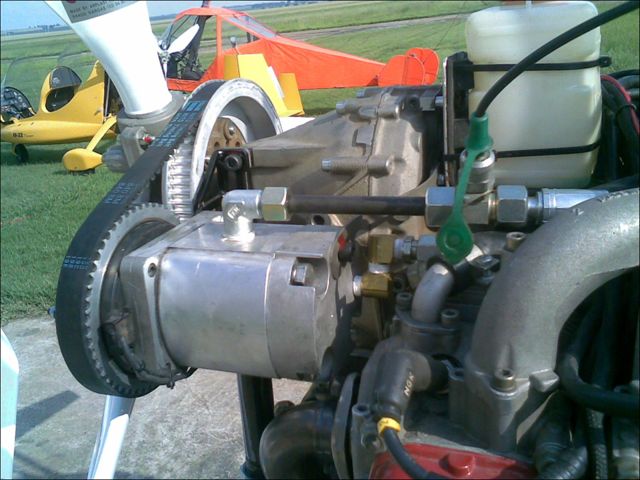

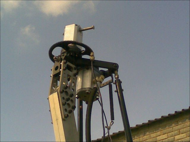

Postby gyrofan » Tue Oct 27, 2009 11:33 pm
Interesting that you mention it. Johan from Wagtail has gone down that development route with the hydraulics. really an incredible system. I have looked over their shoulders during a routine 1200 hour rebuild of one of the machines....the only thing which needed replacement on the whole pre-rotator system was the tooth belt....the hydroulics is incredibly smooth and reliable.
On the topic of jump take off...I have asked the question lots of times and everytime Johan keeps telling me the same thing...LOTS of Hp, only real way is through shafts, hydraulics will just be way too heavy.
Some interesting facts which Johan pointed out was the balance of power to the prop and to the rotor during such high energy pre-rotation......as you ref up the engine to increase the speed of the rotor you also speed up the prop and then the prop absorbs more energy...the end result is that you need a really powerfull motor to accomodate both energy users, or you need some clever uncoupling techniques like the Carter copter croud..
Just to "brag" a bit, I actually had the privelage to witness a jump take off by the small Carter copter demonstrator....boy, what a site, that thing looked like a caged in lion during the ref-up but as soon as the pilot "pushed the switch" the caged in lion transformed into a swan and just glided effortlessly into the air, easily to 150 - 200 ft.....it actually looked good....

Postby Low Level » Wed Oct 28, 2009 11:32 am
THI wrote:for jump take-off you need the ability to prerotate the rotor system to speeds approximately 50% higher that those required for normal flight
Because of the jump, gyro's going upwards, reducing rotor speed at on helluva rate, and the forces working downwards on the blades trying to fly. EEEish. :shock:
gyrofan wrote:Johan from Wagtail has gone down that development route with the hydraulics.
Francois at Rhino had his Sycamore converted. Good concept and spins up to about 220 r.p.m. but it is a bit heavy. Sure it saves about 100m on take-off.
