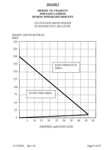

A gyro definitely does have a height/velocity graph, but it is much more forgiving than a helicopter, and would could therefore say more safer than a helicopter when flying low and slow.
The first graph is for the average two seater gyro. In the 2nd graph, from a Bell 204 helicopter, I have shaded in blue where a gyro's height/velocity graph would fit in. As you can see, a gyro can fly much lower, and slower than a helicopter.
Whirly, just like a 3 axis fixed wing, a gyro can fly a power on or power off/glide approach. Unlike in a helicopter, the flare height is not critical at all, and is very similar to landing a fixed wing, except the gyro comes to a stop extremely quickly. You can approach the runway from directly overhead the threshold, or you can fly the flatist approach, that's the beauty of flying a gyro, they are so versatile.

From the 2nd graph, a Bell 204 Helicopter, hovering at 700 ft, and experiencing an engine failure, would not be able to recover with height below him to be able to make a safe landing!

I still wonder about a full engine out landing in a gyro though.Surely you will have a high rod as you push the nose down to gain the speed needed to autorotate, but somewhere close to the ground you need to stop that with a flare. If you just flare in a helo and don't pull the collective to further soften the landing you will smack the ground. Why is that different in a gyro? Maybe because you can keep a nose high attitude all the way to the landing, unlike a helo where you have to level it for fear of a tailstrike? Do they (gyros) just autorotate better?? :?

I know it sound too good to be true, but that is as simple as it gets. When you have an engine out you take the correct glide slope and land the same way as you have practiced a hundred million time. :wink: Silly question, but have you ever flown is a gyro? If not, boy are you missing out! You should really go for a flip, do a (almost) engine out and see what happens. Pure joy!! :P

FO Gyro wrote:From the 2nd graph, a Bell 204 Helicopter, hovering at 700 ft, and experiencing an engine failure, would not be able to recover with height below him to be able to make a safe landing!
THAT is a scary thought. :shock: I have never thought that a heli's envelope for safe autorotation is that large.
whirly wrote:Surely you will have a high rod as you push the nose down to gain the speed needed to autorotate, but somewhere close to the ground you need to stop that with a flare.
Nose down to MAINTAIN autorotation. Maybe that is where the difference lie. Glide ratio is 4:1, and a normal flair can bring your speed down to zero for an absolute normal landing.

At the risk of sounding disloyal to gyro's, I think if I could afford to operate and own a helicopter, for me, that must be the ultimate. Ignoring the legal aspects, but being able to land on the top of a mountain, far from human civilisation must be a real fun. Imagine being able to have a picnic where no one else can get to? I just wish gyro's could do jump take-offs, now that would be spectacular!
I would imagine that the rate of descent of a gyro with the power off, and that of a helicopter during autorotation would be fairly similar. Maybe the chopper jocks could confirm this. Both in a gyro and helicopter, it is quite a steep glide angle. I think I'm correct in saying that the difference between a helicopter in autorotation and a gyro in a glide (that is always in autorotation) is that the airspeed to maintain is not nearly as critical in a gyro. In a helicopter, if you descent too quickly, the rotor RPM will redline, whereas in a gyro it doesn't matter. In a gyro, having sufficient airspeed to be able to arrest the rate of descent is the only important consideration.

Whirly, gyro manufacturers don't seem to have a redline or maximum rotor RPM. In a gyro, if you enter a steep turn, and load the rotor, the rotor RPM will increase, but before it reaches any serious RPM, if the steep turn is steep enough, the indicated airspeed will eventually bleed off - a total non-event.
In a glide in a gyro, flying too slow is absolutely fine. If you have some height, flying at zero airspeed is absolutely fine! I routinely approach over the threshold at 1500ft, slow the gyro down to zero airspeed, and allow the gyro to enter a vertical descent. At about 300 feet agl, I then lower the nose to allow the airspeed to increase from zero to around 60mph so that the gyro has enough energy to flare and land. (If you only start recovery at 200ft, with no power, that is when things can become pear shaped.) It confuses the fixed wing pilots big time when they see a gyro approaching from directly overhead the airfield! vhpy vhpy vhpy
