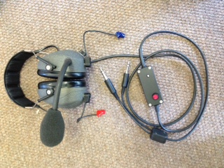

Plugs underneath the headsets
Gyro sets with Hass.JPG (55.16 KiB) Viewed 10845 times
Finished product with Hass units connected underneath. If the Hass units are connected the inner speakers disconnect, then the ear cup becomes a ear defender. The Hass unit also acts as ear defender. Now if that doesnt work.. The headsets are driven by a seperate noise filtering system which is driven by the intercom. So the VOX system will still function. Each system will require the internal mic amplifier to be adjusted..

Looking good Paul!!
Cant wait to get them so we can see how they work.!

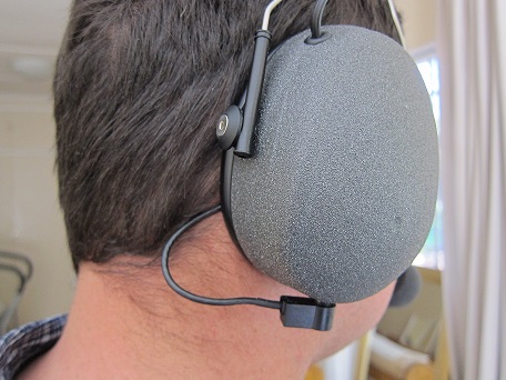

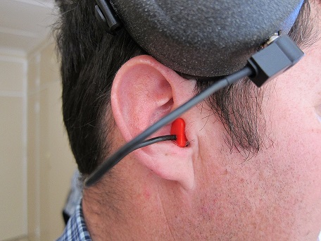

I did receive the headsets from Paul. Thanx Paul
Workmanship and Quality is outstanding.
Here are some pics of the system fitted on my head.
All seems good so far. The hass plugs are super comfortable because they are custom made to fit my ears.
They are amazing. Sound dampening from the outside is absolutely amazing.
I can only imagine the sound to be nothing but crystal clear. Combined with the low noise mic and Pauls full face helmet to keep the wind of the mic, this just might be a winner....
I cant wait to test them in real life. Just waiting delivery of my gyro and will post again...
My first observation.... If this works, it might become the new industry standard for open cockpit and helicopter flying.
Hass earplug in position
Earcup over the hass unit
