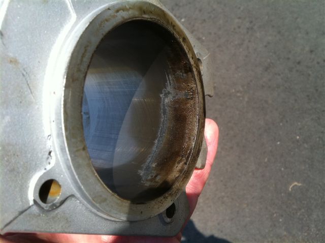

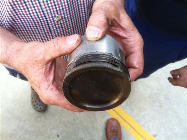

Splinter wrote:No dont lock it, we would like to know the cause of the engine failure.
Glen Meyer at Springs took the engine apart. Quite baffled about the failure. The crown of piston no1 (left back)started burning away, and caused a seizure in the cylinder. Oil, fine water, fine - all info from the engine, airbox temp, pressures fine. (**) No3 ( right back) showed similar signs, but in a very early stage - no damage yet.
A propable explanation might be. When Glen took the cylinder heads off, no.1 and no.4, the topnuts, were loose. The cylinder head bolt nuts could almost be turned by hand. :shock: It seems like there might have been air ingress between the cylinder and cylinder head. ( See burn marks on cylinder head skirt). This could have lead to those two cylinders running lean, with resulting detonation. Cylinders no 2 and 4 is perfect, and bolts were still torqued.
When I bought the Sycamore it had an engine cover, part of the body work. About 20 hrs into training the engine had a heat seizure on pistons no1 and no 3. The AMO then, who opened the engine, told me this happens with these gyros with engine covers, because the cylinders are air cooled, unlike the cylinder heads which are water cooled. The two in the rear does not get enough air - with the engine cover - which lead to them running too hot. Although the water temp are within spec, the cylinders overheat, and one does not pick it up.
The two rear cylinders and pistons were then replaced. I never had put the cover back, and she was running well within specs. Just weird that the top bolts came loose after about 150 hrs. Presume it hapenned over a period of time, and that Friday was the final nail. :?

What you show there and describe is very good signs of Detonation. Our Ozzie mate can take this further, he understand engines better than Rugby...
Loose cylinder head studs on some cylinders will not cause lean mixture under high power, no air will be sucked in during inlet stroke.. The "leakage marks" you will see is actualy from the high temperature combustion gasses leaking out between the cylinder and the head. This causes a drastic disturbance in the combustion front inside the cylinder and this can contribute to higher metal temps. Measure the stud and you will most likely find it a fraction longer than the others...stretch as result of high frequency pulses from detonation. To stay in the air a 914 is continiously running "with Turbo". Even at 27" MAP the turbo is still producing a positive airbox pressure, a MAP of 35" is already a "boost" of well over 7" Hg or 0.5 barg.

The same way we have it. What worries us, is, what was first, chicken or the egg? Did the loose nuts cause the detonation, or the detonation cause the loose nuts?
If it detonated first , why? The interesting thing is, there is no detonation marks in the head, on the plugs or valves.

Hi LowLevel.
Spoke to my uncle earlier today and described your situation.
He is a qulified motormac with years of experience on various engines.
Before I could even complete the story he said, over temp and asked if the rings have seized, to which I had to reply yes.
The headbolts will strech causing the loose nuts as described.
