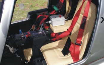

Hey guys , thank you so much for all the mails and posts re Filipe ! We had his memorial in his hangar at Tedderfield yesterday and said goodbye to him.
Now we move on again, reminded of all the corny little pilot quips we have always refered to mostly in humor over the years ... blue skies below rather than above...runway ahead rather than behind... birdstrikes happen , please just not while the bird is still in the tree ... there are old pilots and bold pilots but no old bold pilots around ... etc. etc.
Then again the Charles Lindbergh quote; " If one took no chances, one would not fly at all. Safety lies in the judgment of the chances one takes. That judgment, in turn, must rest upon one’s outlook on life. Any coward can sit in his home and criticize a pilot for flying into a mountain in fog. But I would rather, by far, die on a mountainside than in bed.
-- Charles Lindbergh
Nice post on the Xenon, M24 sightings at Vredendal Learjet !
You are so on the button with your observations.
Butch Brown and I were chatting about the fact that the perfect gyro is still not around but we are wragtag getting closer !Up till then it is still going to be more experimental than anything else.
Yes , you stand a good chance of losing your libido temporarily if you do not plan your enterance to the M24 with care . The Xenon is not exempted ! They have a strap that holds the stick forward and when climbing into the pilot seat you have to consider some manouvering to get your legs around and behind the strap onto the rudders ! We used bungy cords on the first Magnis to keep the stick forward until we patented a type of gust lock which Magni then took up and improved on. Lets hope Xenon comes up with something better than the strap in the next model update ( as well as gasstruts pleeeaaazzz !!!)
Xenon scores big time on heating and ventilation comfort in the cabin. Magni will have to address this issue. Vic froze in his cabin due to the cold ram air through the open vents. He eventually closed the vents on the outside with duc tape and then cooked as the day wore on !
Xenon also has a flaw in this department when it comes to the Kalahari sun taking rifle aim ( dooierus ) on you in the midday heat. The "sunroof" although tinted as the rest of The Xenon's windows, allows the sun to fry your head in spite of the cool air through the vents.
I got a nice solution from dr Fritz Odendaal in Kuruman who suggested that I stick " One way Vision" film on the sunroof... you know the stuff they stick on the windows of taxis and busses ? got little holes in and you cant see in but you see out perfectly ? I did this and it blocks the sun beautifully. Xenon wont think of this because in Europe they once again do not have our African problems ! Maybe future African owners can spec this ...
The tyres on my Xenon are not standard. They are 6 ply Cessna 152 aviation tyres which means no more punctures. The standard 4 ply tyres puncture if a duwweltjie comes within 5 meters of the gyro !
Aluminium rotors versus composite ... aluminium much much lighter and cheaper but has limited lifespan ( I think 5000 hrs ? ) Aluminium spins up much faster ( 250 rpm within 10 to 15 seconds ) and will not chip if you get caught in a rain shower. My friend Dirk van Zyl thinks they spin down / unload much faster than composite rotors but I have not really noticed any difference .
I got feedback from the Xenon designer re my low RPM , high man. press situation at the coast and my suggestion of a variable pitch prop. I was not correct in assuming that the coarseness of the pitch was the only reason. Didnt think of the turbo wastegate setting ! Up here she opens at 41" and must be reset for sea level conditions. ("You talk about variable pitch prop, yes at ONE condition, to equip the machine with a on-flight adjustable waste-gate, to also change the pressure of the turbo.") quote/unquote Raphael Celier.
As far as the engine goes , one will have to see. The factory gives the same guarantee on the RST as Rotax does on their engines. The TBO is 1500 hrs.
I think we have discussed the different engines before and a lot has been said about the RST on the internet forums etc.
About the engines and Turbos
The Rotax 912 S is a 100 Horsepower engine with excellent performance.
The Rotax 914 is an 80 HP engine block that Rotax has added a Garrett Turbo to and boosted it to 115 HP for 5 minutes then full time 100 HP. It has been a very popular engine for many years and is used by the US military in the Predator Drones. The 914 does provide continuous sea level performance of 100 HP to over 12,000 feet.
The 912 RST model uses the same 80 HP Rotax engine used in the 914. This engine has been fitted with a Mitsubishi Turbo that gives full time turbo boost. At full power this engine develops 122 Horsepower and is excellent for heavier loads or high altitudes.
I think the 914 is fine for up here and obviously at the coast. I opted for the RST on the advice of the designer as well as the 8.8 meter rotor to get the best possible performance for high and hot conditions. Up to now the going has been great. 125 hrs clocked since April and no problems. We will see as we go along and I will most certainly keep posting anything out of the ordinary.
Wat is Rugby Eben ?? ooo daai ding wat ons teen die New Zeelanders Saterdag oggend gaan pleeg ? Lyk die RAF nie bietjie soos n rugbybal wat gepluis word nie ? Niemand het nog ooit gesê daars iets met n rugbybal se looks verkeerd nie !! grappie. I loved the individuality and happy fun looks of the RAFs at Vredendal. Very impressive when they came overhead in formation. The RAF is the only side by side locally than can boast a formation at this stage ! Enough of them around !! Xenon next with 5 ( number 6 , 7 and 8 apparently on their way in the near future and then a gaggle of I think 3 more M24 s soon soon.
Our gyro community is growing beautifully.
Last though ... Boet, I think your Bushbaby is a beaut !!! Thanks for letting me sit in her.
