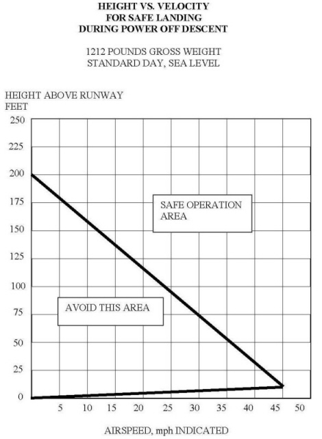

Just to refine the previous post, as per the attached graph, the height velocity graph shows the safe combinations of speed and height in a gyro. A similar, but more restrictive graph exists for helicopters as well.
If flying at 20 mph, at 100 feet AGL and below, and an engine failure occurs, the average gyro will end up landing very hard, with possible damage, and I would imagine spinal injuries would occur. A safer minimum speed at this low height would be around 40 mph. The higher one is, the safer it is to be at a low airspeed. Staying to the right of the solid line is considered safe in a gyro.
HV Curve.jpg (74.16 KiB) Viewed 2630 times

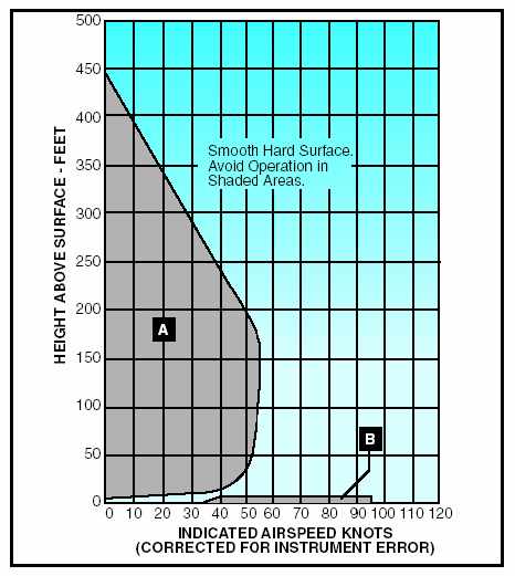

from Rotorcraft Flying Handbook
Height Velocity Heli.jpg (35.29 KiB) Viewed 2573 times

Postby Gyronaut » Thu Sep 06, 2007 5:20 pm
FO Gyro wrote:a R22 should never hover below 500 feet (unles he is a couple of feet above the ground where a safe landing can be made).
At altitude a R22 with two normal sized guys and any more than half tanks battles to hover out of ground effect in any event. On a hot day it descends as fast as my gyro does.
Generally hovering is the one thing that helicopter pilots avoid, in or out of ground effect. Supposedly the only thing a Gyro can't do.
