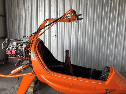

I have contacted JB and have asked him to assist me in loading some pics ...

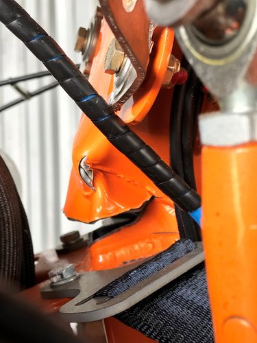

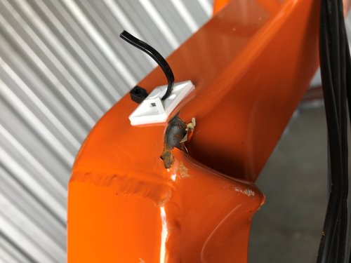

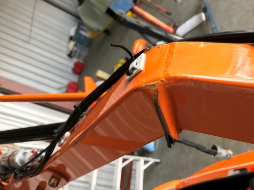

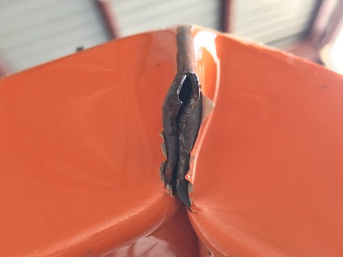

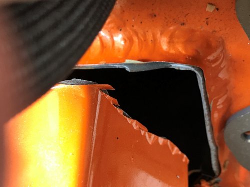

Thanks John B for putting in the pics, ok so this gyro simply had a hard landing the mast folded and snapped in two places, so the weight of the rotors caused this.
The pilot got out with some damage to his hand and was very lucky.
It's said that the manufacturer has reduced the mast wall thickness form 2mm to 1.6mm
