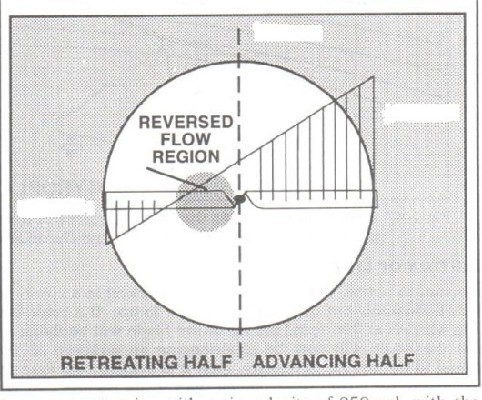

Teetering is the Gyros rotor that teeter from side to side when the rotor is 90 degrees with fuselage.
The picture is of a Gyro from the top.
The blades are rotating anti clock wise.
The forward movement of the gyro causes the reverse airflow as the advancing blade is into the airflow from the front and the retreating blade is with the airflow.- Like flying into the wind with one wing and with a tail wind on the other.
The region is close to the middle of the blade as the blades move slower in the middle and the relative airflow is slower.
You can see from this picture that the retreating blade is now generating less lift than the advancing blade. Only part of the wing generates lift where full wing for advancing blade.
So the retreating blade will move down and the advancing blade will move up. Thus TEETERING.
Then you need to reed my post above this one to understand what happen next.
