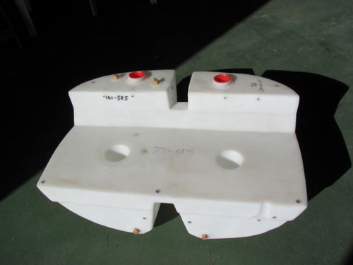

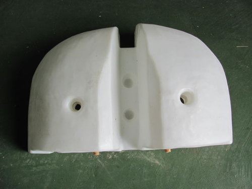

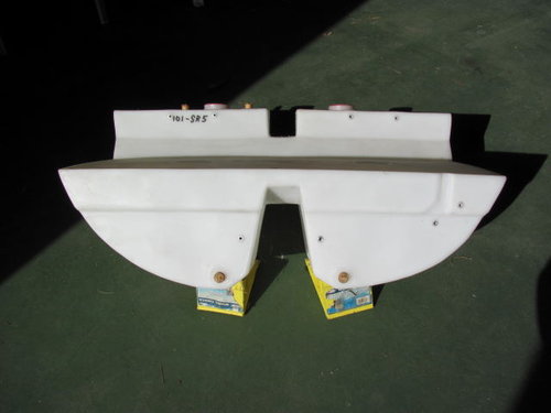

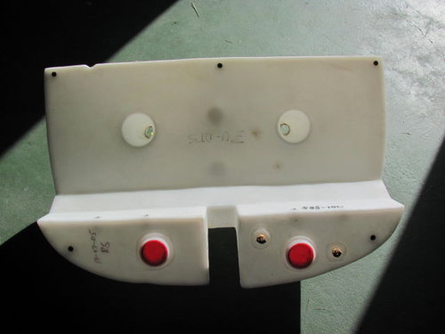

We as a gyronaught community, find ourselves in a very dark hour. What happened at Alldays is constantly on my, and I believe a lot of your minds. We are extremely sad together with the loved ones and friends of our departed fellow gyronaughts and we pray for God’s comfort.
I have spoken my mind about the issue of ensuing fires in a previous thread (“Burning Gyros’) and I am not going to repeat myself. The manufacturers and agents are not commenting first hand and I don’t expect them to. What I do expect from them however, is to come up with improvements to the system – and quick. The answers are hopefully and probably closer and simpler than what we might anticipate. For the sake of interest I attach photos of the RAF pe fuel tank – surely it cannot be as resilient as the Merlin fuel cells, but they are at least 50 times more resilient than fiberglass tanks and the technology is simple and locally available. Sure, this tank weighs in at a whopping 11,82 kg, but the RAF designers have long ago thrown out the fiberglass tanks and added the pe one to an already very heavy aircraft – must have been a hard decision, but so far it has paid dividends.
Please guys, do not let this thing fade away – we owe it to our injured and departed fellow gyronaughts and their and our loved ones – just take a close look at their eyes next time you go off flying – I do not like what I see at the moment – it is not doing my soul any good and I cannot blame them. Surely we cannot eliminate all risk, and that we accept, but we can go a long way to improving the odds.
Fly Safe

Looks like a strong tank Hub-bar, great.
My first choice is still a bladder fuel cell and I am convinced one can be manufactured to fit inside the existing tank for added protection. Cut it open, glue it in, repair it and voila. Yes, it will add weight but its not negotiable as far as I am concerned.
Hopefully the manufacturers will come up with the best and approved system. If we can eliminate the risk of people burning (as too many have) then the price is insignificant. Medical bills exceed this cost in the first minute after the accident.
