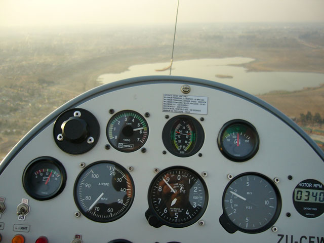

I have a 31 foot rotor on my Sycamore. Taking off she wants to fly at around 290 rpm. Straight and level - one up 340 rpm, two up 360 rpm. I understand the MT03 runs easily to 450/470 rpm on their rotors - 27 feet if I'm correct.THI wrote:What is your take-off rpm on the Sycamore? That should also be lower than the Magni? Magni 28feet;Sycamore 33feet?
I presume you train on an ELA (or MT) with solid shaft pre-rotator. Unfortunately with that you cannot pull back before releasing the pre-rotator. If it has the flex shaft pre-rotator, I was taught to pull back at 130 rpm. Enough lift to clear the tail, and then the thrust from the prop actually helps to spin the rotor up faster towards 180/190 for take-off.I wait until 180-200rpm before pulling back on the stick
A very ugly pic of the smog over Brakpan,
