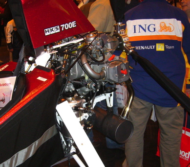

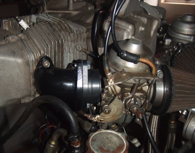

Gunter, I attach a picture of the P and M GT 450 with a HKS 700e motor, that means they will be fitting a turbo when it becomes available next year. The HKS 700 e motor as you will see in the picture has the carbs mounted over the motor behind the prop. Negative pressure area. HKS make horizontal manifolds but they would make the motor sit too far back and upset the weight distribution. I attach a picture of my similar manifolds that I made and cast but they are at a greater angle allowing the carbs to have a almost direct intake of air behind the Aquilla seat. (I have the patterns available for anybody who wants a set) I would imagine the plumbing on the T version will be hectic. I am looking forward to the GT450 HKS 700 T with great interest.

- Carb intakes horizontal and direct air flow in, shorter but hopefully no torque loss !!
- HKS quik.jpg (99.16 KiB) Viewed 8389 times
- Carb intake standard behind the prop and long manifolds for tractor installation.
- HKS Aquilla.jpg (69.67 KiB) Viewed 8394 times

I would be interested in a set of the short intakes for the 700e. Should anyone know where I might purchase a set please advise.
