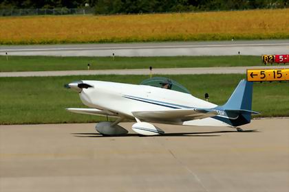

The problem with the KR1 I'm building is she cannot carry the weight of a heavy engine (wingspan is only 5meters). :(
I would love to get my hands on a Jab 6 cylinder but just cannot afford it, :? there is a KR1 in the states with a 120 hp 6 cylinder Jab engine that cruises at 230MPH and climbs @ 2500fpm. (-) :shock: :shock:....
