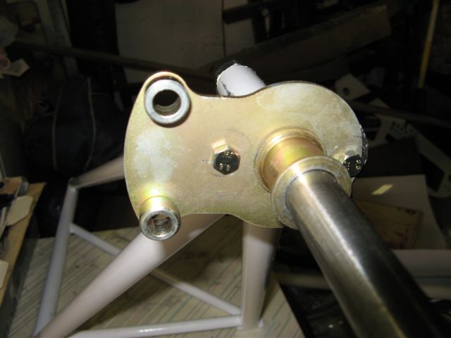

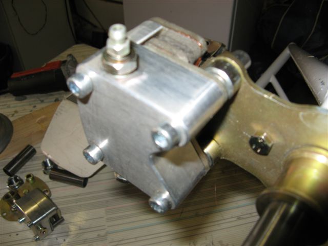

strip the old brake system off the axles (Pic 1). Place the caliper against the backplate, horizontally facing backwards. Drill two holes through the backing plate and fasten the caliper to the plate(pic 2) and (pic 3)

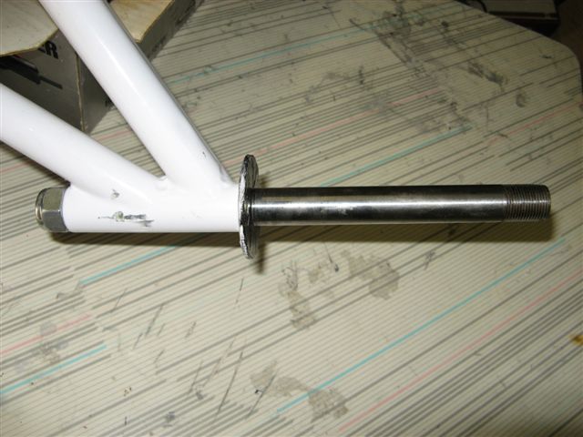

deflate the tyre and split the rim. Take off the old drum and install the supplied disc. (not sure if you need new rims). Test install onto the axle and caliper (pic 4)

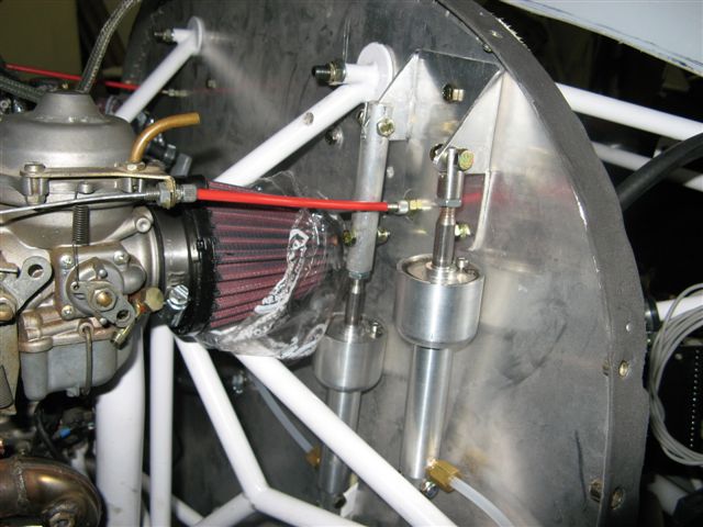

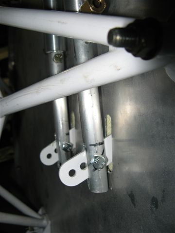

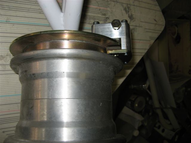

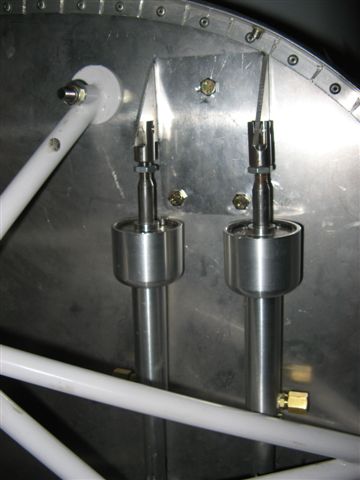

Remove the old brake cables. Make up a bracket to fasten the top of the mastercylinders against the firewall and install the master cylinders. I started with them being parallel(pic 5 and 6) but because the air intake of the 912 gets in the way had to move the one down. (Pic 7)
