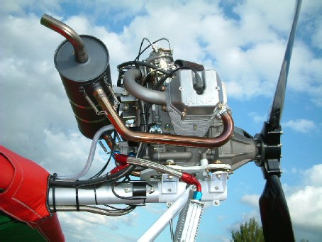

Neat installation....
Neat engine....
Want more horsepower though....
Neat engine....
