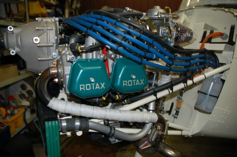

The exhasut is also liable to crack if you have wrapped it in heat resistant bandage
Ian

Postby Ian » Sun Jan 06, 2008 9:58 pm
Morph wrote:The exhasut is also liable to crack if you have wrapped it in heat resistant bandage
Hi Morph, why is that pse ?
additional heat latency ?
I have about 60% of my pipes bandaged up.. thought it kept the heat away up 'top' ..
Cheers Ian
Postby Morph » Sun Jan 06, 2008 10:32 pm
I was warned against doing it by a guy who runs Cowley Performance Exhausts in Cape Town. Apparently the stainless steel cannot dissipate the heat and becomes brittle. As a result it cracks very easily.
Guys in the boating world have used it extensively to reduce the engine bay heat have told me the same thing.
Due to the close proximity of my exhaust and radiator hoses I have opted to bandage the hose, which is rubber and only get's to 90deg as opposed to the exhaust that get's to 800deg C
Ian
Posts: 486
Location: Crosswinds
Postby Ian » Mon Jan 07, 2008 5:31 pm
Thanks for that info Morph, makes sense..... now... :?
Anyway I will leave mine as it is for now and watch it, if one cracks I will dig up this posting and advise all.
Cheers Ian

Postby Boet » Sat Jan 12, 2008 8:26 pm
Ian, one that was all bandaged up like yours, broke on a Kalahari Bundu Bash. It had the properties of very thin cast iron. The welding job was very difficult, as the ONLY welder was BIG and the ONLY welding rod available for miles and miles around was about 4mm thick. Imagine pulling a prickly-pear thorn out og an elephant`s ass wearing boxing gloves. That was a bastard of a welding job. :shock: :D :D :D :D
